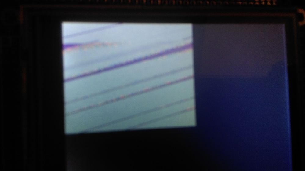

I am trying to capture data from ov7670 camera using DCMI and display it on LCD(later I want add some image processing). I'm storing image in QCIF format on internal RAM and then I'm sending it to LCD.
So far only LCD is working, but I cannot make camera working. When I'm trying to display captured image I'm always getting something similar to this:
Stripes on image changes colors and sometimes there are some noises.
Maybe there is problem with DCMI or camera registers configuration?

Looks like the raster length is wrong. You could try playing with that so the display straightens out. If this were my issue I'd inspect the rasters and bit maps, looking to see if any of the data in them was consistent or provided any insight.

3. Use horizontal, vertical lines to see if the frame contains vertical line pattern. If the vertical line look diagonal going down left, the total horizontal pixel per line is too small (h total too big = h pixels + h blanking)

LCD is working good, I can draw borders and i tested it drawing image similar to this
Problem was with blanking, but (what is strange) QCIF resolution is 144x176 and in my case its 144x172 so there is no h pixels + h blanking, but h pixels - h blanking.
I still have problem with colors, image is purplish and when I configured camera to display color bar colors are wrong, but I will try to find something on arduino forums.
I will check tonight if bits are not swapped.
