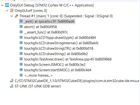

2019-11-27 2:15 AM
Hi Martin,
I've changed the project to a 175x175 in order to get a uint16_t framebuffer that fits in the inner RAM and I stll get the same error, so it does not seem to be some memory overflow problem.
Here I attach you the image of the current function where my code gets stuck (exit() function in syscall after LCD1bpp:drawGlyph())
2019-11-27 4:07 AM

2019-11-28 4:46 AM
Sorry Martin,
It was an error from my side, the project wich I was working had an empty screen, that's why there was no error on glyph. But now I've added text to it and its crashing again.
It crashes on LCD1bpp::drawGlyph() inside __assert_func()
