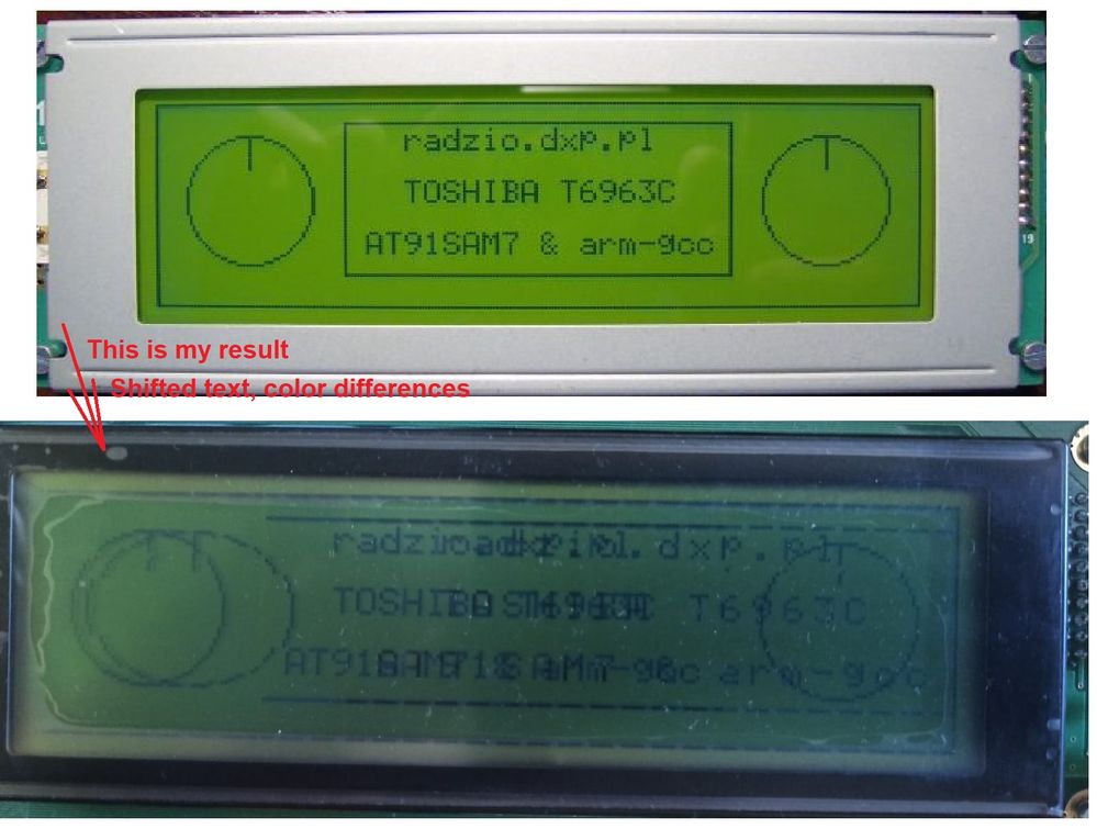

2020-01-31 12:39 AM
Sorry for not putting the model.
It is for the T6963C model.
I have already modified the code of http://en.radzio.dxp.pl/t6963/ and it does not work correctly.
Text and drawings on the LCD are messy.
Is there no way to get a T6963C functional library for STM32?
Thanks you very much.
Best regards

2020-01-31 2:24 AM
Hi and thanks for your answer
I have checked the hardware correctly.
I have verified PIN to PIN that the signals arrive correctly on the LCD.
I also checked the code in case there was an error in any bit but I can't find anything to prove the error.
This is my result:
