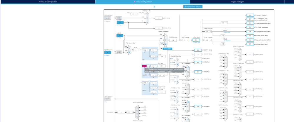

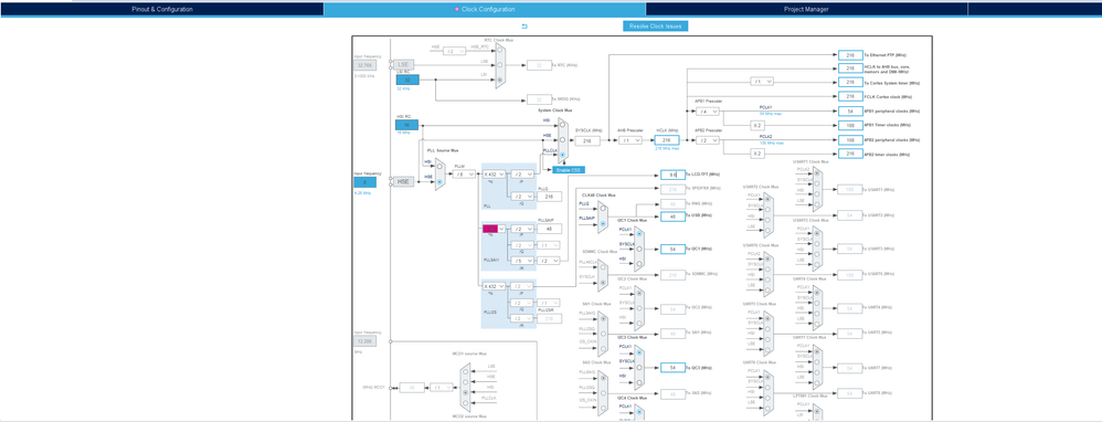

You are right, the timing on the LCD-TFT is way too high. I've been messing with this timing, *N on PLLSAI1 cannot be set to less than 100 without cubemx barking at me about it. I ignored the errors and what do you know! it works!
I have attached some screenshots of the "errors" that cubemx throws when I change *N and /R values.
2020-01-31 12:36 AM
I had a whole host of problems with just setting the values. Cube would not update the values and selecting the dropdown box was a huge pain.
Are you writing in the field? I thought it was just an output value :)
2020-01-31 4:46 AM
You can type into the LCD TFT field and CubeMX will attempt to back calculate all of the divisors and multipliers. It is hit or miss. In this case I manually found the proper values because CubeMX refuses to accept the values that work.
Please, don’t get me started on the drop down boxes agggggghh! Those things are a pain!!!!
