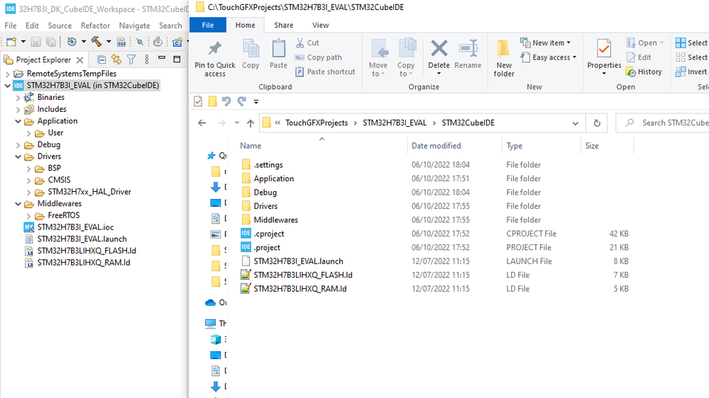

I am trying to figure out why my folder structure in the CubeIDE's project explorer does not match the folder structure I have in my file explorer. Every tutorial I've seen online for using TouchGFX or any other sample code has the two matching, but mine does not. When I look through the list, I can't find multiple different files too. For example, in that project explorer picture I sent, there are no header files in any of the folders. So clearly something is wrong and I don't understand what.

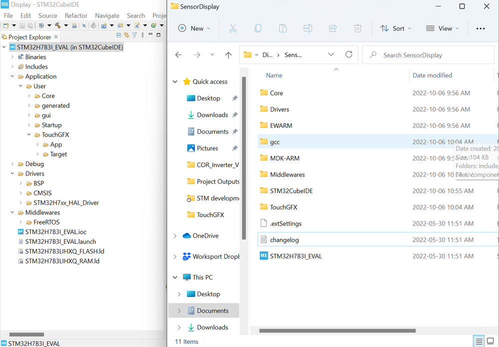

I share with you a CubeIDE project created with TouchGFX where I aligned the IDE (on the left) view and my explorer view (on the right).
For me both structure are identical and all folder, source file and header are present.
And I do not understand why you do not have the same ?
Good luck

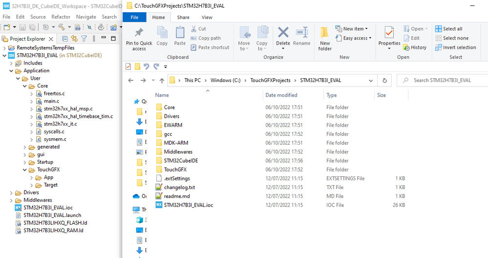

Hello Romain,
I unfolded the folder in my previous response to do a comparison. I've copy and pasted how mine looks when I create a TouchGFX instance and hit "Generate Code."
This is how it looks, which you can clearly see the differences.
I am confused as to why yours constructs properly and mine does not. Could this be a workspace setting issue? I need to know a solution so I can actually follow tutorials and start learning STM32 programming.
I apologize if this is seeming difficult, but I am at a complete loss.

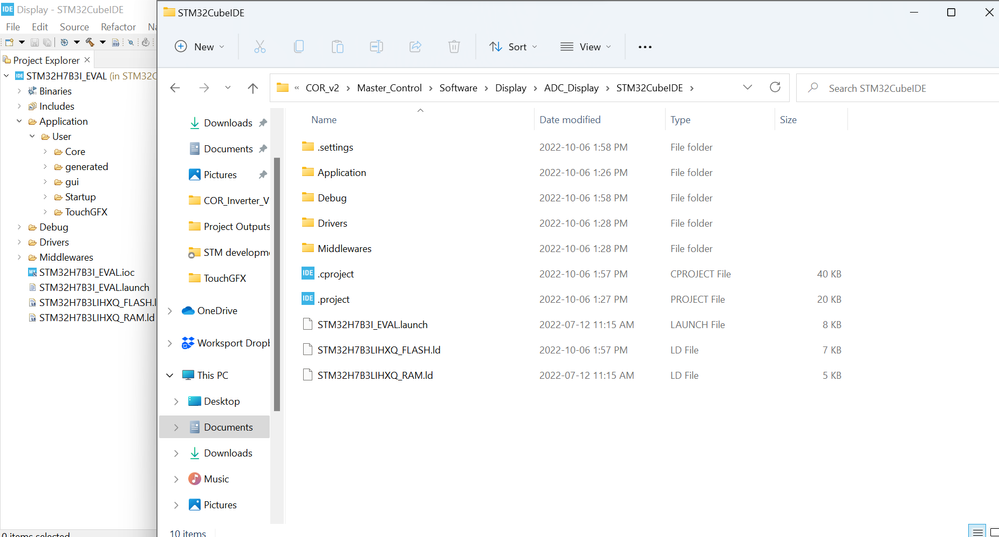

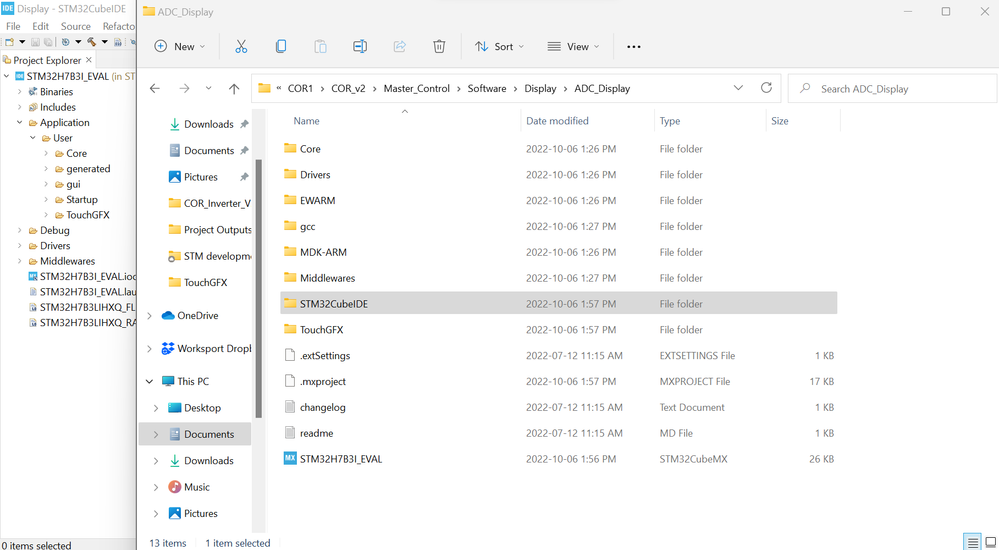

The level I'm looking at (ADC_Display) does not match what's in the project explorer. I went into one of the subfolders (ADC_Display/STM32CubeIDE) and I found a matching file directory! Now, it still poses an issue because this project folder is missing things like the header files and such. Does this information help at all? The .project and .cproject should be in the ADC_Display folder, not ADC_Display/STM32CubeIDE folder, correct?

Again, that's is normal because STM32CubeIDE as a configuration view of it's root folder that is STM32CubeIDE\
"I went into one of the subfolders (ADC_Display/STM32CubeIDE) and I found a matching file directory!"
Yes and that is what I already explain to you yesterday and just above.
"Now, it still poses an issue because this project folder is missing things like the header files and such. Does this information help at all? The .project and .cproject should be in the ADC_Display folder, not ADC_Display/STM32CubeIDE folder, correct?"
No your project generated has no issue. All sources and header file are located on folder above \STM32CubeIDE, like ..\Core or ..\TouchGFX.
