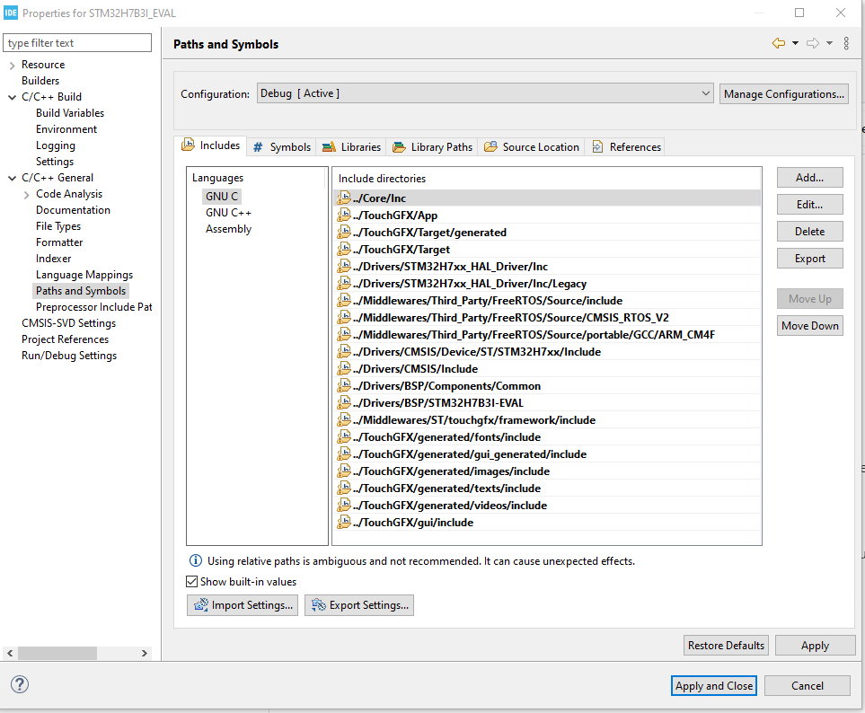

No your project generated has no issue. All sources and header file are located on folder above \STM32CubeIDE, like ..\Core or ..\TouchGFX.
Yes these informations are mandatory and STM32CubeIDE is able to found them because the path of the project are correctly configured (see following picture)
These folder path configuration are also into the .cproject file.
I confim again there is no issue in your generated project.

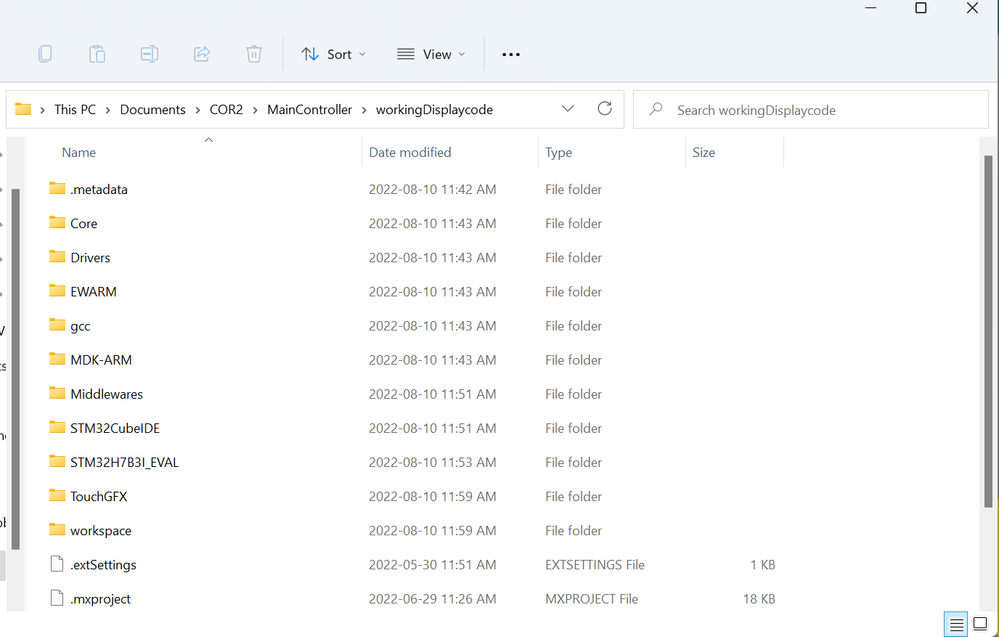

There's something I clearly don't understand about how these projects define the files for the workspace. I had a previously working project folder. I imported it to another folder (because I wanted to organize my work), and now the previous project folder does not work at all.

For your problem it is clear that when you imported your original project into a new location you probably broke the project links. How did you do this import, manually ?
Can you check in the STM32CubeIDE folder (from your file explorer) that it contains the files:
.cproject and .project?
It is also strange that all your directories are in the same directory as the .metadata which is used for the configuration of the Eclipse workspace?

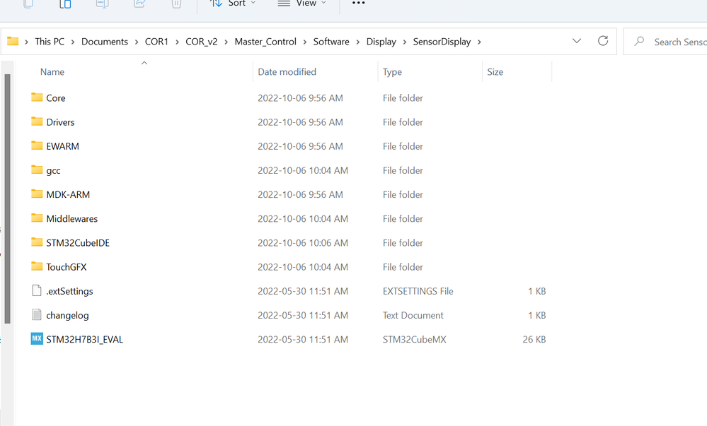

Also, I tried creating a new TouchGFX project and I'm running into a similar problem as before. The project explorer files are incomplete. It is only showing the files in the .ioc executable. Why can I not see Core, Drivers, EWARM, gcc, MDK-ARM, Middlewares, STM32CubeIDE, TouchGFX?
My folder directories are shown in the picture and my workspace is set to Master_Control/Software/Display.

If .cproject is missing, indeed it can't work well.
STM32CubeIDE needs both .project and .cproject.

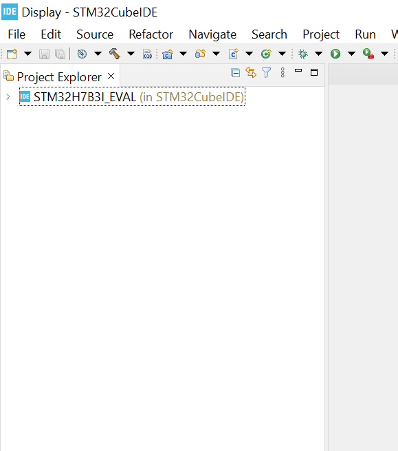

"Also, I tried creating a new TouchGFX project and I'm running into a similar problem as before. The project explorer files are incomplete. It is only showing the files in the .ioc executable. Why can I not see Core, Drivers, EWARM, gcc, MDK-ARM, Middlewares, STM32CubeIDE, TouchGFX?"
In your new TouchGFX screen capture, the project is not incomplete, it is just folding.
In STM32CudeIDE project explorer window, you have to unfold the project to see all the files (the arrow on the left of the project name) Core, Drivers, TouchGFX and friend.....

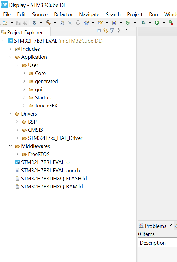

Also, sorry, I did have it folded, but I did mean that the folder structure is still not correct in there. It does not align with the folder structure in my file explorer.
