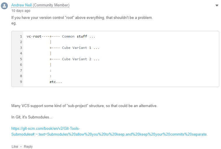

2022-06-06 3:36 AM
@ktrofimo you need to post as a 'Code snippet' for the formatting to work; eg,
