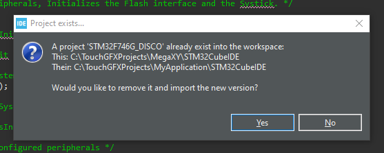

TouchGFX is currently creating projects with a name that is derived from the name of the selected board. This leads to problems when you try to open two projects that have the same board as basis because the project name (internal) is the same, even the name of the project folder is different.
To avoid this, you can rename the entire project so that the new project name is reflected throughout the structure. This function is not implemented yet in TouchGFX, but you can do it manually:
You could write a script for it (e.g. using PowerShell under Windows), but maybe this will be fixed in one of the next versions of TouchGFX.

I tried the procedure again, but on another machine, and you're absolutely right, @Peter BENSCH . It works without trouble.
So I traced back the steps on the very computer that showed this behavior, and the culprit is the Eclipse project naming.
All projects (not project folders, but projects names) issued from TouchGFX, when using the same template, appear in STM32CubeIDE with the name of this very template.
Here's the example :
So I wager a project renaming from Eclipse (namely STM32CubeIde) was done around step 6) or step 7), which led to this re-generation garbage : the project name mentioned inside the .ioc file wasn't matching, I guess ?
Still, this TouchGFX project naming is a bit of a issue: what's the point of asking for the Application Name in TouchGFX's wizard is it's only reflected on the .touchgfx filename, and not the final C++ project generated by TouchGFX Designer ?
