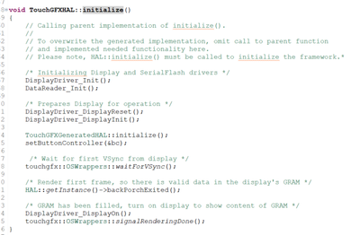

I'm using the GFX01M2, so I imported the MB1624ButtonController, MB1624DataReader and MB1624DisplayDriver files.
I see that in these files most of the files are already implemented and that I only need to change the names of certain variables which correspond to my pin names.
Using the debug I noticed that my program never executes and remains stuck in the TouchGFXHAL::initialize() function at this call: HAL::getInstance()->backPorchExited();
That this means ? I don't really understand this call.

You have copied this file from the U083 TBS (TouchGFX Board Setup).
Not all TBS are similar, they are board specific.
When looking into the U083 TBS project, I can see in the HAL.cpp file :
* Has to be called from within the LCD IRQ rutine when the Back Porch Exit is reached.
virtual void backPorchExited()
swapFrameBuffers();
tick();
I am pretty sure you have not implemented a LCD Interrupt request routine.
Overall, just copying files from another TBS is not the right way of creating a new TBS.
You should look at the link I provided earlier.
