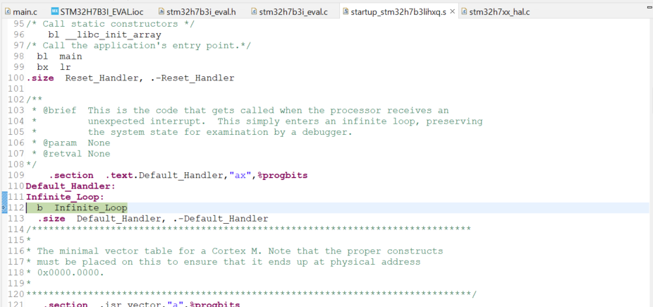

I am using the STM32H7B3I-EVAL evaluation board with a code generated by TouchGFX 4.20.0. My goal is as follows:
To do this, I am using a timer (TIM2) set to PWM Generation CH1. The code below is how I initialize this timer.

}When I run this, the display seems to work and I get no errors. However, when I click the wakeup button, the display freezes and I enter the default handler. I have set the wakeup button to the lowest priority on the interrupt (15). Does anyone know what would cause this?

If an IRQ handler is not defined in the code, a default implementation is used in the interrupt vector table, the DefaultHandler. So it looks like the original IRQ handler for your button is not present.
Compare your project to the STM32Cube_FW_H7_V1.10.0\Projects\STM32H7B3I-EVAL\Examples\BSP example which comes with the firmware package.

2022-11-02 1:09 PM
Hello KnarfB,
Thank you for the reponse! Yes, I did put a breakpoint in my BSP_PB_Callback and noticed it is never entered. So that confirms that.
I ran the example code you mentioned and it does work, but I cannot find a discernable difference between the two. The main does it as follows:

Hello Piranha,
Interesting, I thought the EXTI15_10_IRQHandler initialization would be handled in the BSP_Init, but I see I was mistaken.
I added this line and my code worked.
Thank you very much! ^.^
