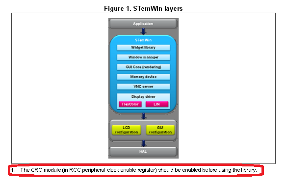

/* Enable CRC clock */ RCC_AHB1PeriphClockCmd(RCC_AHB1Periph_CRC, ENABLE); Prior to calling the function.2013-08-01 8:14 AM
Hi Clive,
Thank you. This is correct and mentioned in our documentation to call that function prior to use GUI routines. I thought that the default examples are used, which is active by default. Cheers, STOne-32.2013-08-01 8:31 AM
2013-08-01 8:42 AM
I'm working blind with the register data you provided, the library is locked to STM32 hardware with this, presumably the F2 and F4, I didn't check the location on the F1
I think the documentation would have been a lot stronger if the main() example explicitly included this code. That note on the diagram is totally lost.http://www.st.com/web/en/catalog/tools/FM147/CL1794/SC961/SS1743/PF259225
