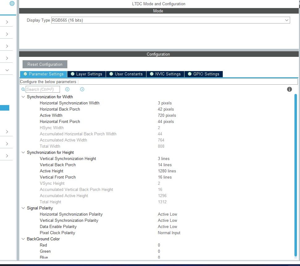

2. TouchGFX is already setup and LTDC is setup to the timings described in the https://www.adafruit.com/product/5793 init code.

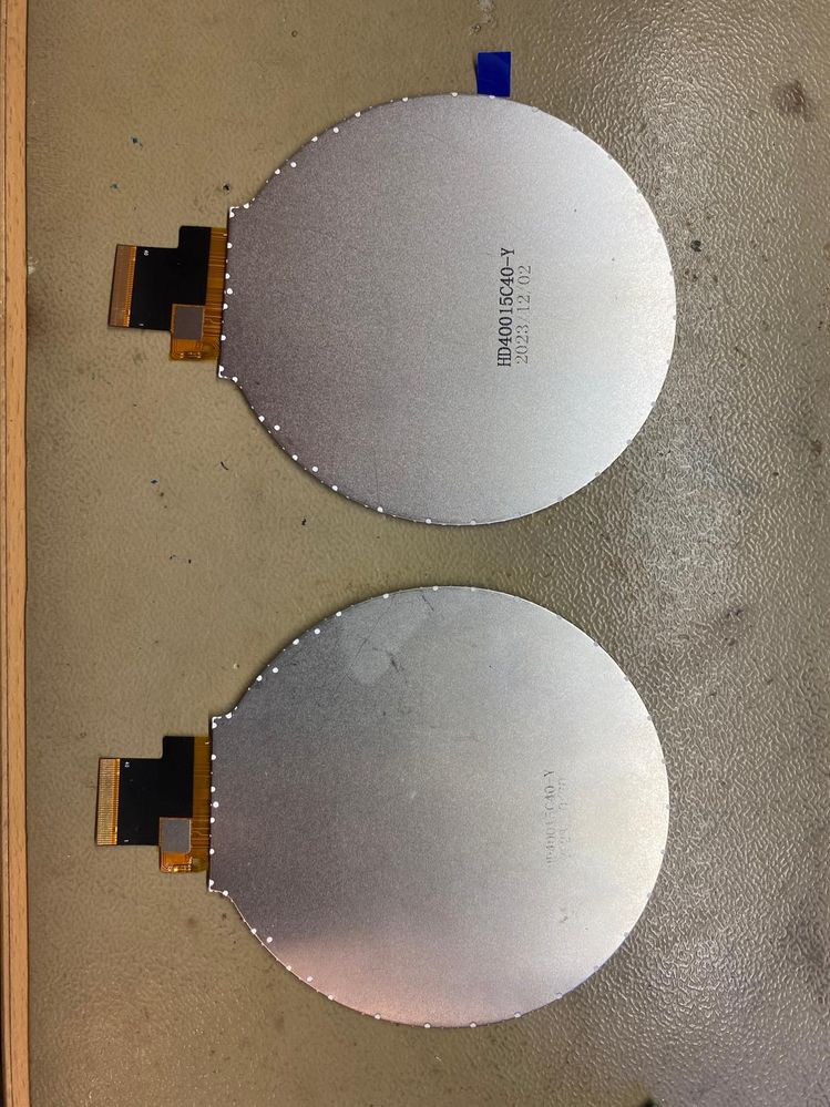

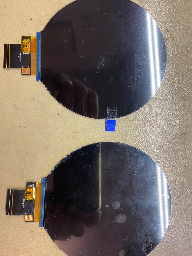

I just want to write here how we solved our (maybe similar) issue.
Before that I need to clarify. We were two people, and we were thinking to have the same display (same P/N and same shape). My friend was using a microprocessor, while I was using the kit from Adafruit driven by the microcontroller.
What we discovered when we met is that the display from the Adafruit kit worked very well in the kit, and also attached on the microprocessor. The other display (bought on a chinese web shop) was not working at all on the microprocessor, and worked very bad on the microcontroller too.
So the error was mainly an HW error.
We tested inverted polarity on VS and HS, but nothing changed on both displays: the original one always works very well, the chipper one doesn't work (on the microcontroller you can draw just (very badly) text console, but no graphic at all.
Her are the pictures of the two displays:

Okay, latest update:
Some extra information to bring up. I am using the STM32U5G9J-DK2 with the pinout modified to work on the display. I've modified the code such that it should work with a 720x720 framebuffer and do SPI init on the display. So in a sense I am not starting the project on a new board. That said, I don't believe this should cause the display to not work. If you create a project based on this in TouchGFXDesigner, you will end with the same base code I have.
I've purchased the Adafruit Microcontroller to compare. My SPI init sequence is 1 to 1 according to logic analyser with the exception of chip select not being down the whole time, I changed that and it didn't make a difference.

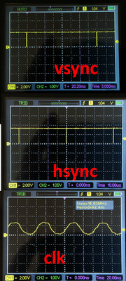

The next thing I did was start probing the clock signals on the Adafruit. I found it to be running at 12Mhz. I was using the rainbow demo and it was flickering however I think this is a problem with the code Adafruit provided and not so much the init or display itself.
I also measured the colour signals on the oscilliscope and found that to be sending data as expected.
And then I found out that my STM program is not sending any colour signal on the oscilloscope and that the Model::Tick() only runs once and then does not continue... This seems to be a problem with my codebase so I decided to start a new STM project.
Now I have colour signal again however... it is still the white stripes. I am at square one again.
The display refuses to display any of the LTDC signals despite receiving valid PLK, VS, HS clock signals and even colour signals (measured on oscilliscope).
The only signal I haven't been able to verify is the DE signal due to the small probe to measure. Even then, I think it is unlikely data enable isn't working.
Would anyone know how to extract the Vsync, Hsync FP and BP values from the adafruit. If it makes sense, it should be the same as the ones provided by Adafruit themselves and I should not have to investigate this.
Maybe some things I can try is bit banging directly to the RGB outputs. Or somehow testing LTDC before entering TouchGFX and RTOS loop, if that is possible?
Otherwise mostly, I'm not sure where to go from here.

First off, for digital signals, use a logic analyzer. An oscilloscope and a logic analyzer are not the same thing. You said you used a logic analyzer for the SPI init code, and I would recommend you to use this as well for the display signals, as it allows you to measure the signals with respect to each other (in other words, measure every signal at once). It's how I figured out the vertical and horizontal porches for my display (screenshot attached. I'm using Digilent analogDiscovery2.)...
As for the model.tick running only once. I had the same problem (doesn't mean the same cause). The solution was to remove the HAL_LTDC_ProgramLineEvent in the LTDC_IRQHandler in the stm32u5xx_it.c file.
Lastly, it is definitely possible to test the display and LTDC without TouchGFX. The STM32U5G9 should have enough internal RAM that you can store the framebuffer internally, so this ->https://support.touchgfx.com/docs/development/board-bring-up/how-to/03-display-internal shows how to do that.

about the signals polarity , see my bellow settings in MX for F429 Discovery .
this might be helpful .
what I remember (in 2022), at first attempt of LTDC setup in MX , I got the working display.
regarding the difference in datasheets of NV3052xxx (which i haven't checked) , my experience about SUFIX difference in cog part number doesn't bring significant changes.
let me know , your views .
