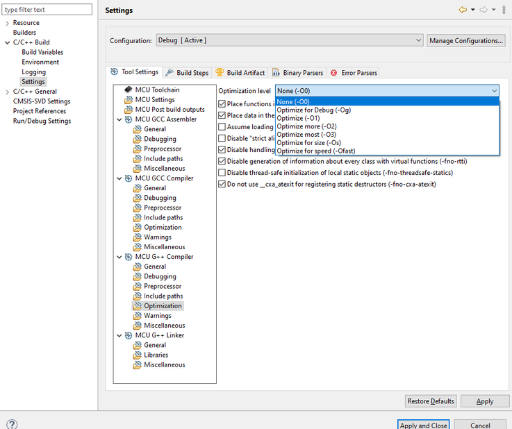

Optimize level config for C and C++ ???

2025-01-16 10:34 PM
try use higher value as you have now...
2025-01-16 10:45 PM

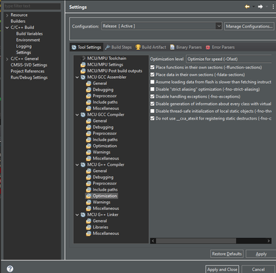

I have this configuration

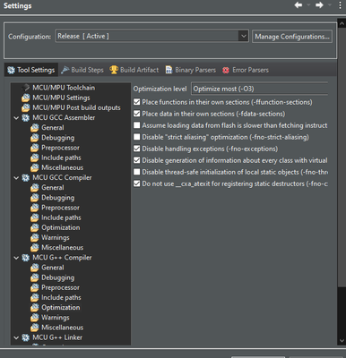

Ahhh set -O3 in both G++ and GCC
2025-01-17 1:32 AM
still getting the same issue

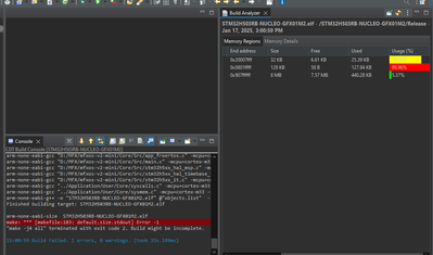

Are you sure SAME? I dont see previous error... And manage your app is your job, what you ask?
Open memory details in App analyzer on your screenshot and locate issue...

Not actually i dont know why this error is occurring. also in memory details i see that most of the space in flash is occupied by .text region (112.4kb/128kb).
I am using handleKeyEvent function for navigating and selecting the ui elements. i am wondering if this causing an issue?
is there any way of storing the code in SPI flash and access that. for this i have made changes in .ld file but the bootloader doesnt know about it.
