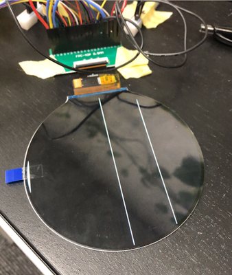

Hi Everyone I have a some difficulties with bringing up the HD40015C40-Y display with TouchGFX or even at all:
1. I used the init code provided by adafruit, I set up my SPI with 9bit words and sent it to the display as per the datasheet for the NV3052CRGB datasheet.
2. TouchGFX is already setup and LTDC is setup to the timings described in the https://www.adafruit.com/product/5793 init code.
3. I have very strange rainbow lines behaviour
Currently I am running a 35Mhz clock. The 35Mhz clock was derived from the linux device tree overlay for the HD40015C40-Y display.

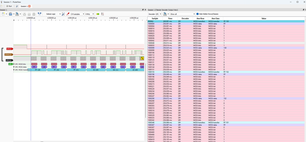

4. Things I do know: SPI transmission definitely works. There are physical signals for the LTDC pins coming from the STM chip as I checked with an oscilloscope.
Interestingly if you read the Circuit Python code from Adafruit, they only have 16Mhz frequency.
I have no idea if this is a software problem, hardware problem or a combination of both.

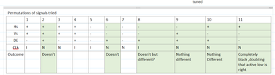

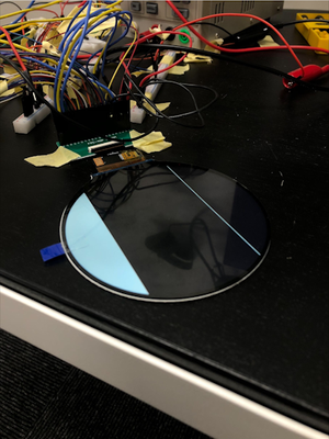

}I've had different permutations and combinations of Vsync and it has yielded different artefacts such as the number of lines appearing. However none of this reflects what my GUI design is supposed to look like.
I have the image even TouchGFX GUI animating in the simulator but there is no change on the display.
So it seems to be stuck somewhere between SPI initialization and LTDC? If I turn off the power, it will lose this state. So SPI init seems to be working to an extent, however I cannot see the desired image. Anyone have any ideas?

Regarding, the minimal init sequence you are sending the bytes with 9 bit words in STM32?
9bit cmd + 9bit parameter? + 9bit parameter? How is this achieved?
compared to the Write_Reg_3052(cmd,param);

I have been working on a similar screen, and I have had similar lines. I doubt that it is the initialization code, because it wasn't for me. I tested it two ways - I found that the display controller has an onboard register that displays a white screen when set, and another which displays a test image (if your display controller is a Sitronix ST7701S, the code in the file attached can display those images). If you can get those, your initialization code is arriving properly. The other way I tested it was as follows. I bought an HDMI converter board which can correctly initialize the display and run it, so I hooked up a logic analyzer to the relevant SPI pins and was able to capture the initialization code, and it was identical to what the manufacturer for the display provided. This leads to what I think is the problem: I hooked up the logic analyzer to the HDMI board and was able to get the sync timings, porches and polarities. The signals that came out of the HDMI board were completely different to the signals from my custom board, and the polarities were not what I expected from what the labels suggest (Active High did not mean what I thought it did). So, the polarities and timings were wrong.
Hope it helps :)
Kind regards, Cloud

Hi INaee,
thank you for your reply. I've turned my LTDC clock down to 4Mhz to ensure a stable signal.
My logic analyzer confirm the SPI is correct even with hardware based SPI1 configuration in CubeMX. My SPI is 100% correct, I can use Display ON, All pixels on commands etc.
This means that either the init code is incorrect, or the display timings are incorrect which is consistent with what @CommanderCloud has said.
I have one question however regarding my specific display. There seems to be a inconsistency in the code provided by Adafruit. The init code refers to the NV3052CGRB driver IC. However the manual provided on their website is the NV3052C. These have different datasheets.
https://www.buydisplay.com/download/ic/NV3052CGRB.pdf
https://www.phoenixdisplay.com/wp-content/uploads/2019/05/NV3052C-Datasheet-V0.2.pdf
Of course I am using 18bit + SPI in either case.
@GPaga is it possible to use logic analyser on the VS, HS, porch timings of the ESP32-S3? Maybe there is inconsistency between STM32 and ESP32?
In green are the permutations of cubemx settings I tried for LTDC:
I haven't tested different timings yet however.
All behavior on my screen so far has only led to different combinations of "white lines" on my display. But always white lines.
Kind Regards,
Skele.

Today I will do some tests changing the polarity of then synchronism signals (VS, HS, DE).
It is really difficult to understand what is wrong with your or mine setting, what I realized is that a single error bit in the page 3 register configuration leads to the vertical leads artifacts (small changes in many of the other registers generates bad synchronism or flickering).
I'll keep you up to date.
