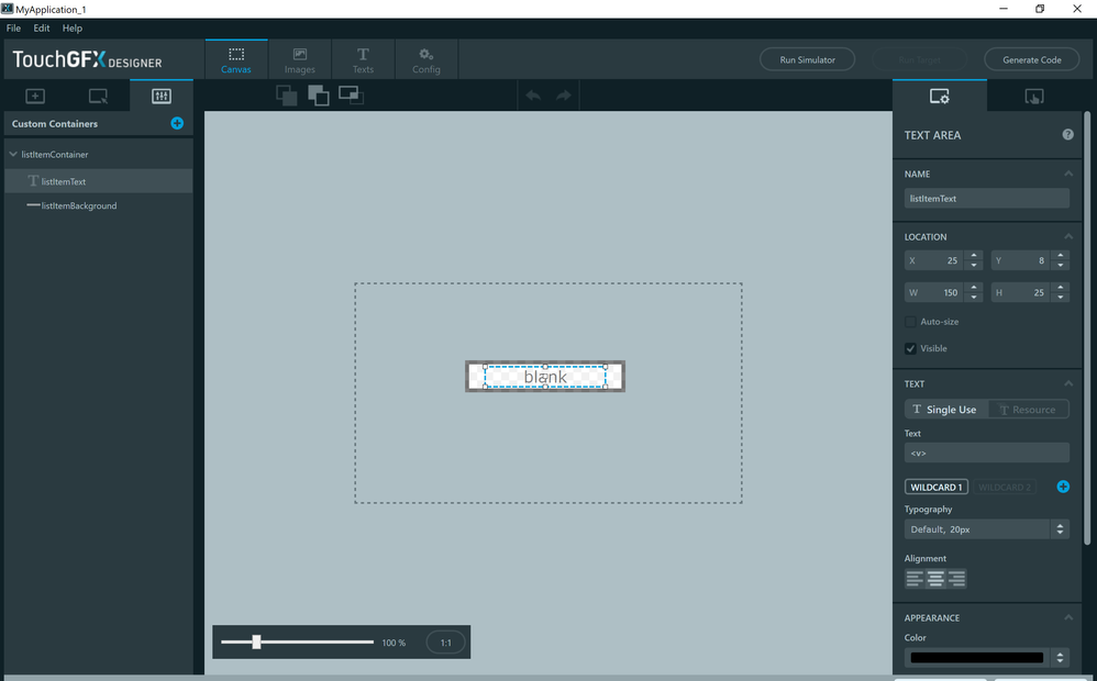

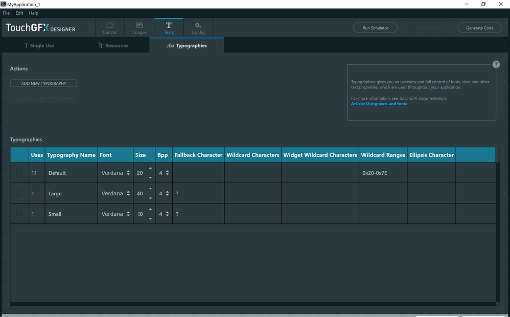

I have project currently running in the simulator only. One screen consists of a swipe container with several pages, in the swipe container is a scroll list. I've created a custom container for the scroll list and one of those widgets is textArea. The text area contains one wild card. I've unchecked Auto-size for the text area, set the text as <v>, selected Wildcard 1 as single use, checked Use WIldcard Buffer and set an initial value. In Typographies, I've set the Wildcard Ranges for that typography as 0x20-0x7E. I use the following code in my screenView.cpp

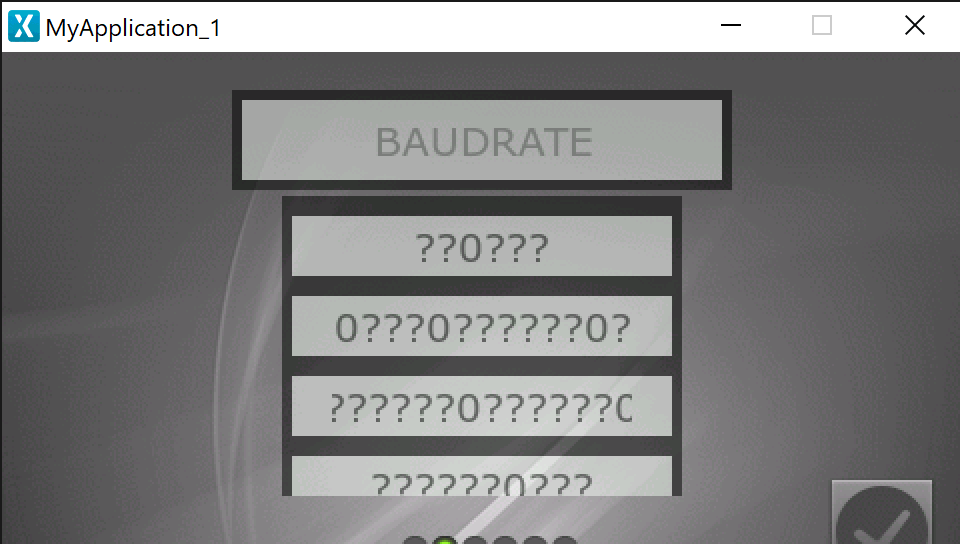

}Everything compile, links and runs but I get the following behavior with the text:

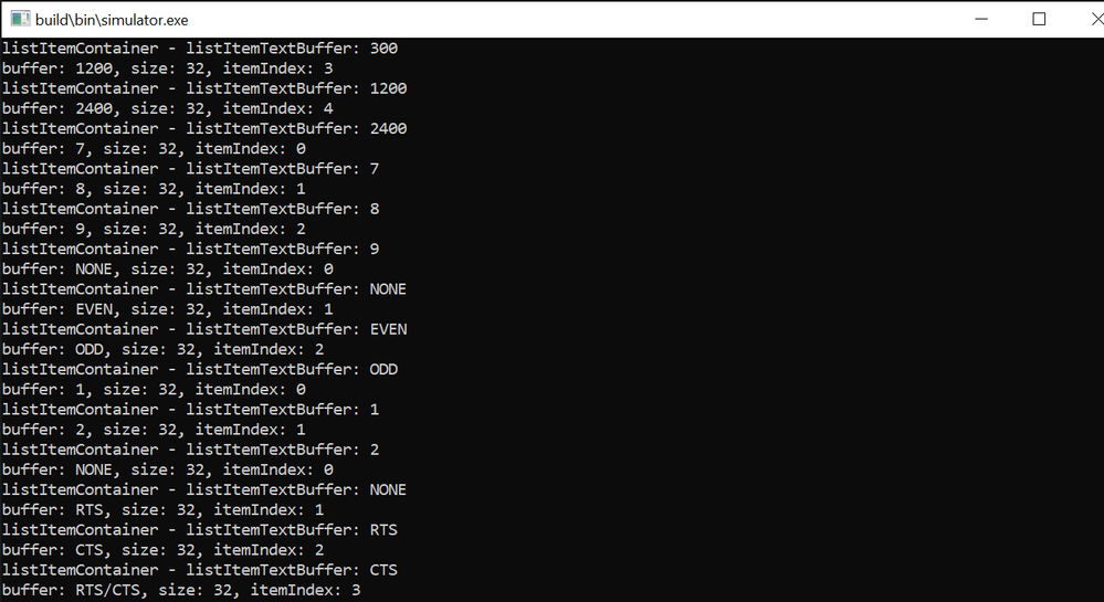

But the output of the touchgfx_printf() calls indicate all is copying well
Because I'm seeing question marks, I assume it is a typography issue, but even if I change the fallback character to blank (should generate an exception), I get no exception and no change in behavior. The text that is printed is consistent from run to run, so that leads me to believe it isn't a pointer that points to garbage issue, but maybe that's a bad assumption?

}making it an issue of the null terminating character not being correct, with the touchgfx_printf() and Windows console print somehow being able to figure it out
Foiled by printf() again!!!!!!!!!!!!

UPDATE: It does seem to be a typography issue. I set the fallback character to blank and did a make clean and a generate code and then run simulator and got an exception on 'R', which is in the range. Not sure what exactly I'm doing wrong.
