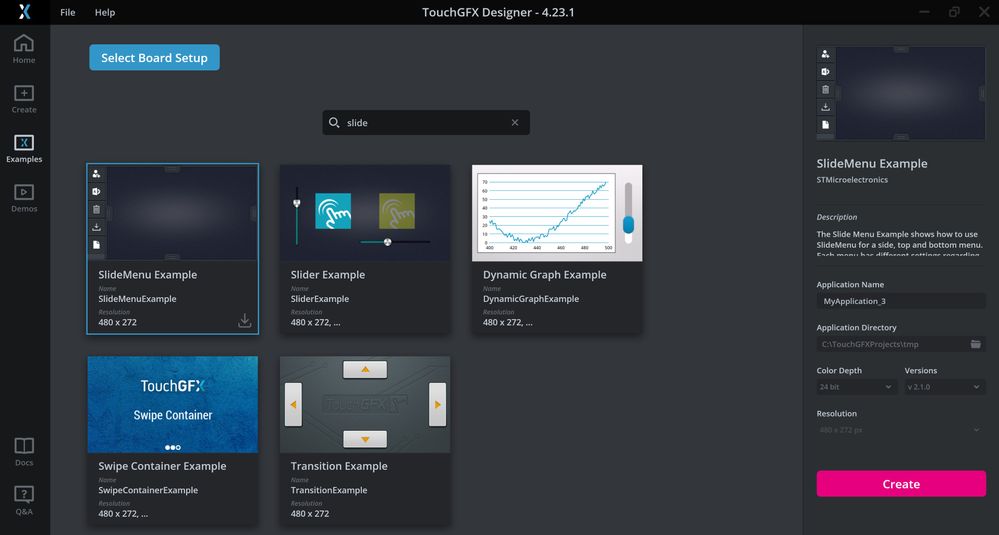

Hello @JNova.0 ,
You can start working on Slide Menu when it is Expanded. You need to adjust the button that you are going to use to trigger expanding and collapsing next to the elements you want to show when expanding. Then, you can set the state to collapsed and set how many pixels should be visible. So, in your case, the width would be 60 and Collapsed: Visible Pixels 12.
There is an example specifically for Slide Menu, and you can see other use cases of it in TouchGFX Demo 1 (Graph Screen) and TouchGFX Demo 7 (SVG Sub-demo).
Slide Menu Example
