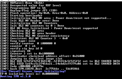

The following is the output when commenting the function set_rcc() and commenting the above snippet.

Both these approach are giving same errors. going into reset. If i am commenting the new test that has been added and executing the TFM Example, the example runs fine without any issues.
