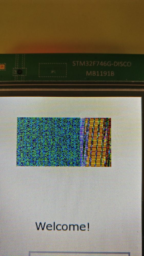

2019-05-13 7:36 AM
Hi!
It seems that using the integrated or standalone CubeMX doesn't mess up the project. Also, I succedeed in importing your project under AtollicTrueSTUDIO in order to see the difference between the IDEs.
I followed @hansd56's link in order to configure the QSPI:
https://touchgfx.zendesk.com/hc/en-us/articles/360019884752-Configuring-STM32F746G-DISCO
I followed as well this tuto to configure the linker under CubeIDE (I think that is it the same as AtollicTrueSTUDIO):
All is building perfectly and when I look at the Build Analyzer, I can see the ExtFlashSection and my assets under QUADSPI.
The problem is, when I launch the debug, it seems that the flash is not programmed and my screen print this instead of my beautiful picture :(
Of course, I tried to use internal flash, and everything works, my picture is well displayed.
Do you have any idea of the source of my problem?
Thank you,
Charles
2019-05-14 12:32 PM
Is your BPP (bits per pixel) set properly?
