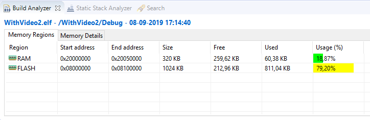

The issue is that all assets (fonts, images etc) are stored in the internal flash of the MCU. this creates quite a memory footprint even with just a few font sizes and backgrounds.
This picture shows the memory usage with just 2 screens with two different font sizes (20pt and 200pt) and a single button. We are already maxed out here!!

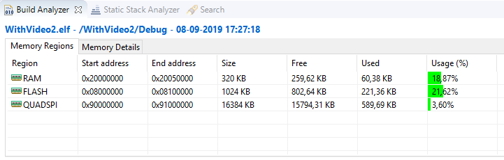

*/With this change in place we can do another build of the project and the memory footprint now looks like this:
A pretty radical change :) You should be able to fit almost anything into that QSPI footprint.

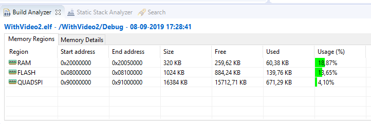

Now the result is this:
So this is it. By adding to the linkerfiler you get muuuuuch more space in your application :)
