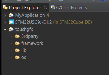

When creating a new project based on STM32U5G9J-DK2, TouchGFX designer defaults the project name to My_Application#, but when the project is generated it' still based on the TBS default package name of STM32U5G9J-DK2.
This seems to cause issues when opening the .ioc project in STM32CubeIDE, because the .ioc is still named STM32U5G9J-DK2.ioc and not the same as the application name:
There are further issues with the linker file not matching, and a sub project being created with the name STM32U5G9J-DK2 and then main.c and other files in the sub project being used for build.
This seems to mean that if you have an actual project named STM32U5G9J-DK2 (e.g. the demo) and then created a second project named MyApplication_4 when you try to compile MyApplication_4, files from STM32U5G9J-DK2 project will be used.

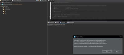

I get prompted to remove files which are conflictual (same name):
Which makes STM32CubeIDE clean the workplace.
I recommend you to open projects by double clicking on them (.project file) in the file systems explorer.

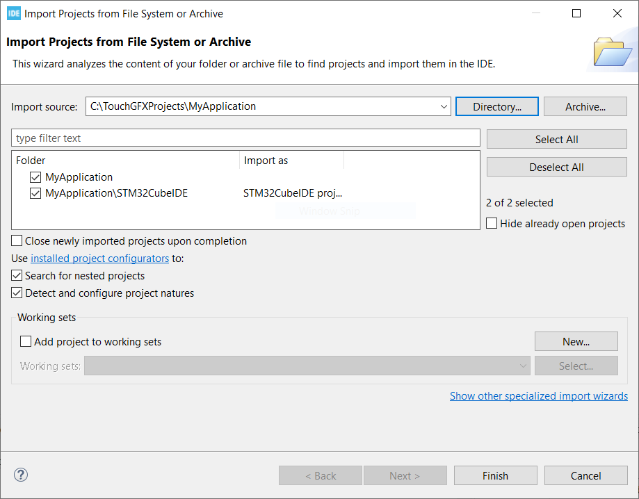

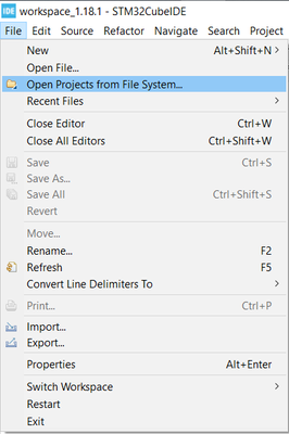

I open project from the file system:
And then:
And then it makes a mess of it :)
