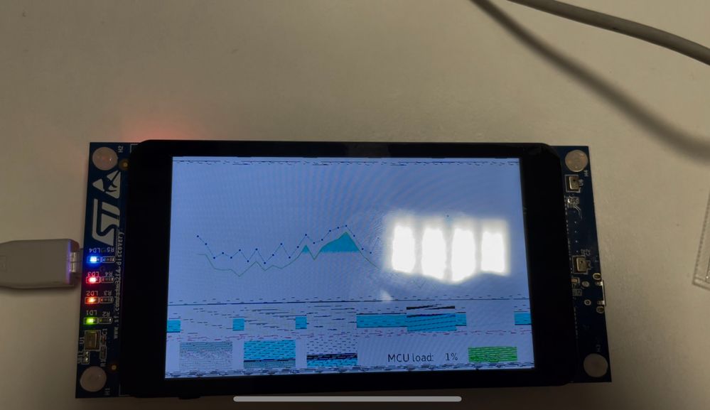

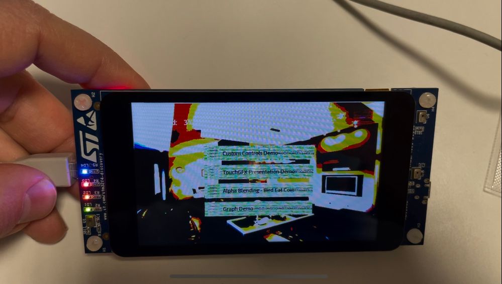

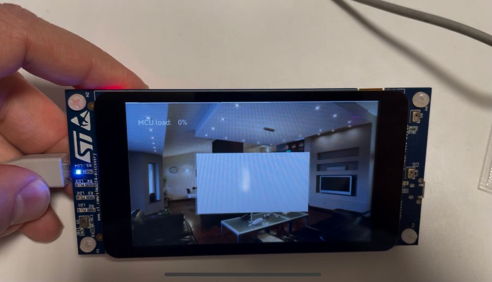

Those are some pic of what happen if I run te TouchGFX demo from CubeIDE
0693W000006EzTqQAK.jpg0693W000006EzUnQAK.jpg0693W000006EzUsQAK.jpgAfter any reset pressure on the rear of the board the sequence could change... It's really strange.
In the other side, if I "Run Target" any example from TouchGFX the screen is alwais black. When I push the reset button 2 leds blink, and I can see the backlight that fade on. But nothing appear on the LCD
