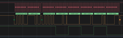

For testing purpose I'm transmitting the array {0, 1, 2, 3, 4} on the microcontroler and I'm receiving [4, 0, 1, 2, 3] on the pi.
Here's a screenshot. The green line toggles when I put a byte in tx register.

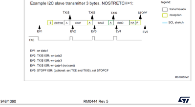

From the reference manual, I found this explanation:
It shows that data should placed in the tx register before the start.

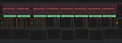

To do that, I tried to put the first byte in tx register during the read frame. The result is slightly different but still wrong : [5, 1, 2, 3, 4]

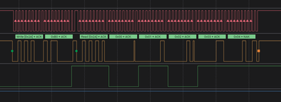

I managed to make it successfull by sending nothing during the last TXIS interrupt of the frame but I'm not really satisfied with this solution. It looks ugly.
Is it the good way to do it?
