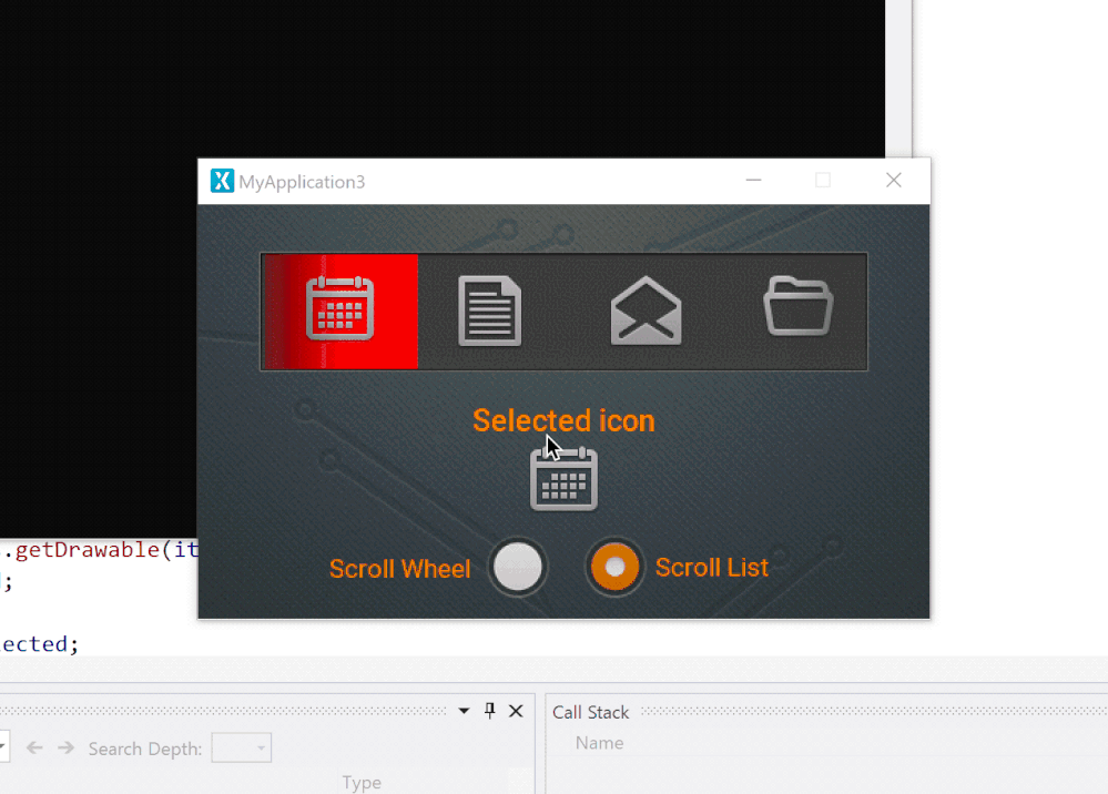

In the 4.10 update, there is new class scrollList, the item selected was
// The callback updates the selectedIcon bast on the itemSelected parameter
void Screen1View::scrollListItemSelectedHandler(int16_t itemSelected)
}This function will be give to callback
void Screen1View::setupScreen()
// The item selected callbacks are registerd with scroll wheel and list
scrollList.setItemSelectedCallback(scrollListItemSelectedCallback);
}However, the issue is the call back only give a ''int16_t itemSelected'' call back parameter, I some case, I would like to update the ''drawable'', but the feedback is only feedback a itemselected, I could not know how to know which drawable I am working on.
Suggest to have following function:
1, provide a function: getDrawablenumber(int16_t itemNumber), the feedback is the drawable number, so I could use this
Drawable* d = scrollListListItems.getDrawable(last_selected % numberofDrawble);
imageContainer* cc = (imageContainer*)d;to get the imageContainer.
2, the setItemSelectedCallback give two feedback, one is itemselected, another is drawable number.
Here is the effect I am looking for, as you could see, the red background will be updated when I selected the item. I did this using a not very general way, I changed the total item number into 15, and there is only 5 drawable, so, I could use (itemselsected%5) to get which drawable I am using, that means, my item must be 5, 10, 15, 20... ect.
