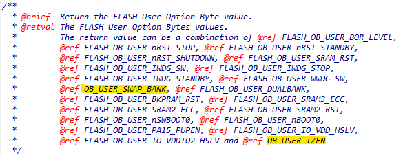

The reference to OB_USER_SWAP_BANK seems significant, since all the others are prefixed with FLASH_.

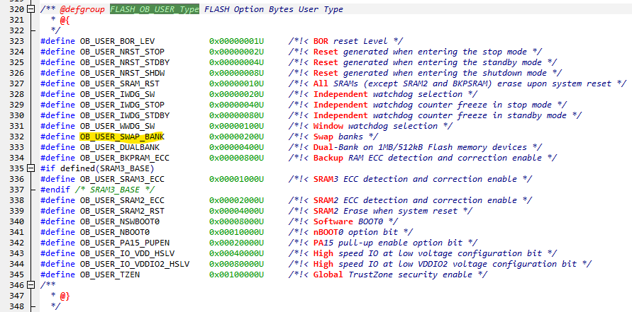

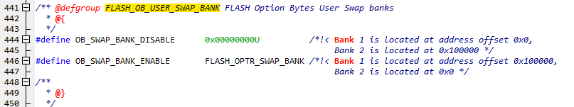

OB_USER_SWAP_BANK is 0x200, which does not correspond to a relevant bit in FLASH->OPTR. Like the other return values, I think this should be the defgroup FLASH_OB_USER_SWAP_BANK instead. The options in that group include OB_SWAP_BANK_ENABLE, defined as FLASH_OPTR_SWAP_BANK, which is indeed the SWAP_BANK bit (1<<20) in FLASH->OPTR.

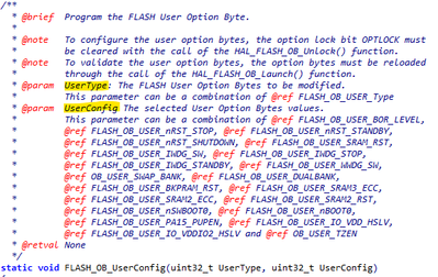

As far as I can tell, OB_USER_SWAP_BANK should only be used as a UserType in FLASH_OB_UserConfig(). Which means the comments on that function, the FLASH_OBProgramInitTypeDef struct, and the FLASH_OB_USER_Type defgroup are all back to front as well. That means all the IS_OB_USER_* defines are misleadingly named as well. Correcting these to make a distinction between the FLASH_OB_USER_* defgroups, and the OB_USER_* UserTypes seems readily achievable and a big improvement in usability.

The reference @ref OB_USER_SWAP_BANK should be replaced by the corresponding type group @ref FLASH_OB_USER_SWAP_BANK, which includes defined items:
- OB_SWAP_BANK_DISABLE
- OB_SWAP_BANK_ENABLE.
the following one:
It appears that the original Doxygen tag comment reference was a mistake (highlighted in yellow).

The same fix should be applied to OB_USER_TZEN by adding the FLASH_ prefix.

Besides, the FLASH_OB_GetUser() function returns the "user option-bytes type", which is a logical value defined independently of the OPTCR register bit definitions.
I don't think so. That the incorrect assumption I made too, based on the comments. As you can see in the code I included in my post, it literally returns the register value. The definitions in the "FLASH_OB_USER_* groups happen to be the register bit values. The logical values only seem to be used for FLASH_OB_Config().
Thanks for following up.
When replacing @ref OB_USER_SWAP_BANK with @ref FLASH_OB_USER_SWAP_BANK, and @ref OB_USER_TZEN with @ref FLASH_OB_USER_TZEN, the references will match the function's return type, which corresponds to the current value of each option byte.
Yes. I think we're probably saying the same thing, though I don't know what you mean by "value of each option byte" precisely. It's subtle and there's a few comments that get it back to front. I attempted to list them in my OP.
But I think we agree? FLASH_OB_GetUser() returns the actual register values, which are defined in the FLASH_OB_USER_* groups. The replacements you list will correct that function's comment.
On the other hand, FLASH_OB_Config() takes "logical" values like OB_USER_SWAP_BANK , so the comments I mentioned in the OP are back to front. As far as I can tell, that's the only function that uses those values.

Additionally, as you mentioned, the function FLASH_OB_UserConfig(uint32_t UserType, uint32_t UserConfig) takes as parameters the logical type "UserType" and the corresponding value to be configured "UserConfig".

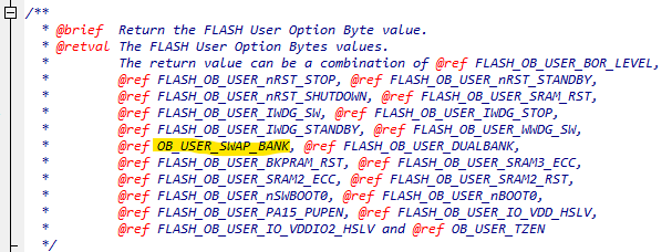

The fix should be applied to both the static Set and Get functions:
