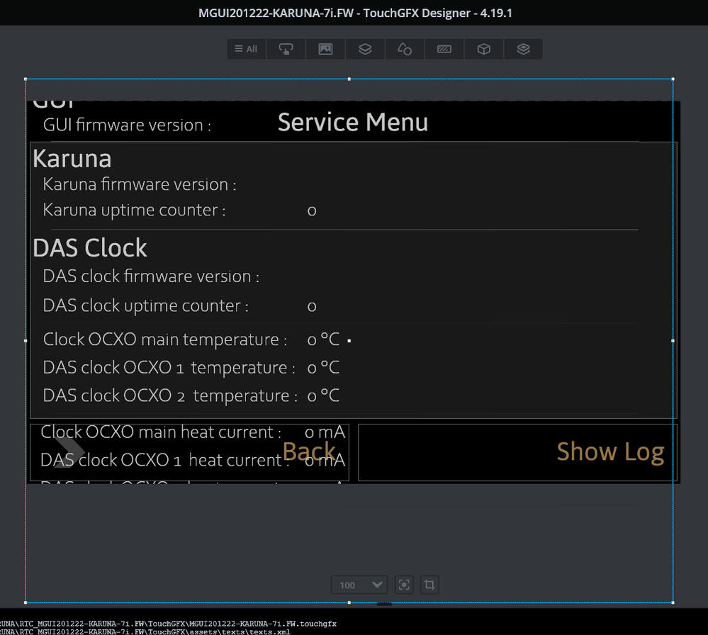

Please help me! How can I to scroll in design time in a scrollable container? I want to create an interface, what is have more info than can fit on the screen. That’s why I want to scroll , because that's it very complicated to do the design. Is this possible at all?

Unfortunately, that is not possible in TouchGFXDesigner.
If you want to have a better overview of your interface you can maximize the size of your Scrollable Container, and then resize it to the normal size before running the application.
