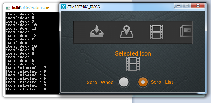

https://community.st.com/s/question/0D50X0000Bed8tjSQA/scrolllist-item-selection
The video attached by member seems should work as my requirement also .
https://community.st.com/s/question/0D50X0000B09SiC/visible-items-in-scrolllist
Same by this member .

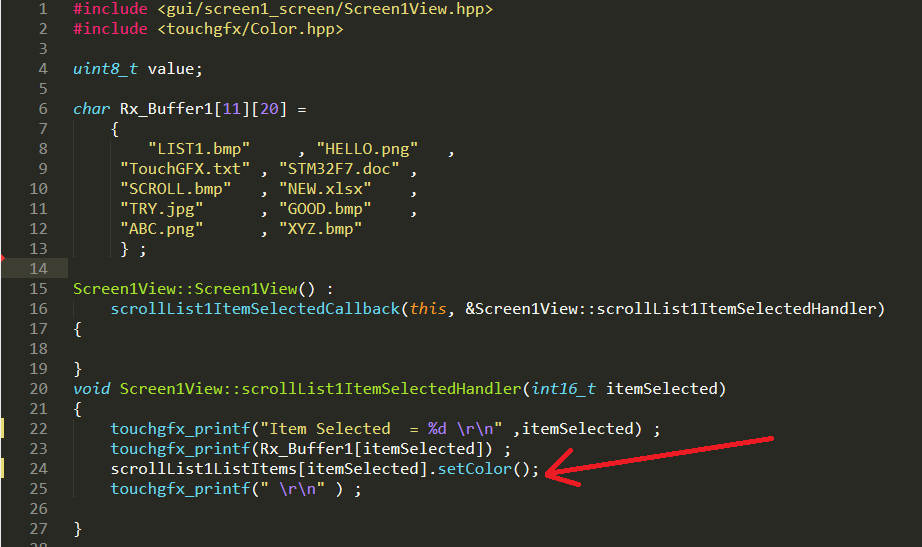

}You can change the color like as follows:

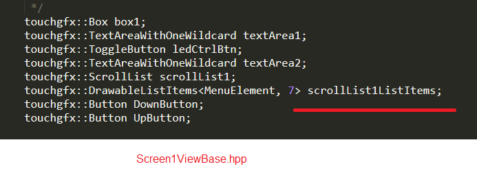

scrollList1ListItems[itemSelected].setColor();ScrollList1ListItems should be declared in Screen1ViewBase.hpp

Hi @Alexandre RENOUX (ST Employee),
Thanks for your update ...
I am doing as below as your suggestion .. Able to send "Selected File name" of touchgfx_printf
But still not able to change the color of selected item ..
Please check and update ..

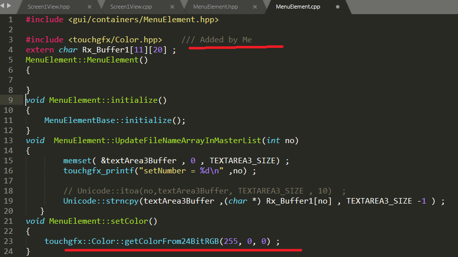

2020-05-12 2:28 AM
Your function setColor won't do anything. If you look at the code for getColorFrom24BitRGB(), this only returns the color with the amount of Red, Green and Blue that you set as parameters.
To set the color you should call a function like:
box.setColor(touchgfx::Color::getColorFrom24BitRGB(255,0,0));/Alexandre

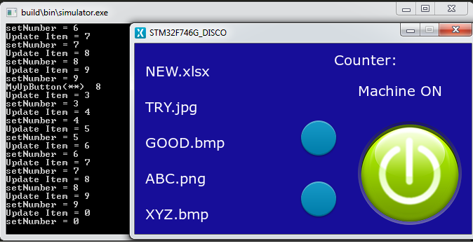

2020-07-15 9:11 PM
For Scroll item in list you can do like this.You can replace Touch Buttons to Hardware Keys
void Screen1View::MyUpButton()
touchgfx_printf("MyUpButton(**) %d \r\n" , selectedMenuItem ) ;
selectedMenuItem++;
if(selectedMenuItem > 10 )
selectedMenuItem = 0 ;
scrollList1.animateToItem(selectedMenuItem,1);
scrollList1.invalidate();
void Screen1View::MyDownButton()
selectedMenuItem--;
if(selectedMenuItem < 0 )
selectedMenuItem = 10 ;

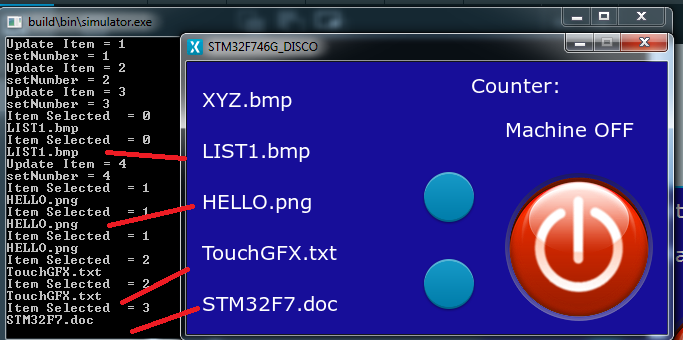

}Item selected / un-selected can be done like below:
oid Screen1View::scrollList1ItemSelectedHandler(int16_t itemSelected)
touchgfx_printf("Item Selected = %d \r\n" ,itemSelected) ;
touchgfx_printf(Rx_Buffer1[itemSelected]) ;
touchgfx_printf(" \r\n" ) ;
// touchgfx_printf("Test %d\n", itemSelected);
for (int i = 0; i < scrollList1ListItems.getNumberOfDrawables(); i++)
if(!(scrollList1ListItems[i].isSelected()) && itemSelected == scrollList1ListItems[i].getIndex())
for (int j = 0; j < scrollList1ListItems.getNumberOfDrawables(); j++)
if(scrollList1ListItems[j].isSelected())
scrollList1ListItems[j].setUnselected();
// scrollListListItems[currentIndex].setUnselected();
scrollList1ListItems[i].setSelected();
currentIndex = itemSelected;
void Screen1View::scrollList1UpdateItem(MenuElement& item, int16_t itemIndex)
touchgfx_printf("Update Item = %d\n" ,itemIndex ) ;
item.setIndex(itemIndex);
// touchgfx_printf("test %d\n", itemIndex);
if(item.getIndex() == currentIndex)
item.setSelected();
else
item.setUnselected();
}Hope this helps to you..
