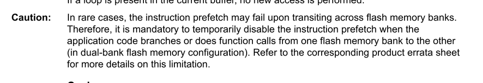

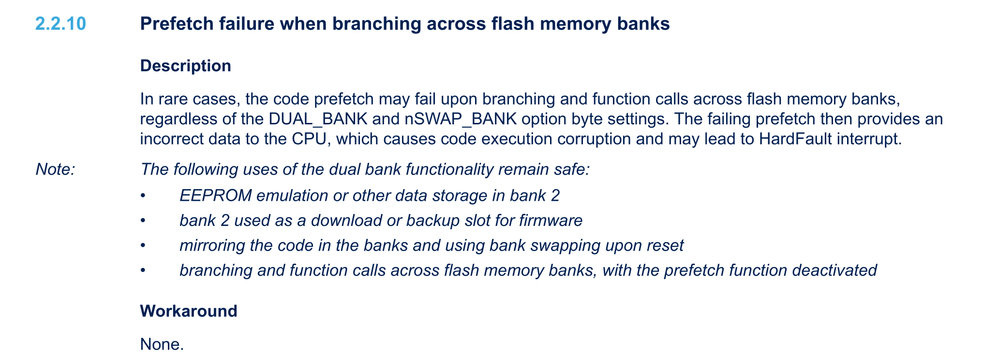

You say your code is "big". Is it by a chance bigger than 128K for a 256K part / bigger than 256K for a 512K part?
Maybe you are running into a silicon errata regarding dual-bank flash. Basically when you have dual-bank flash, you can not have code in both of the banks. Otherwise the processor core crashes in weird ways, typically hardfault.
and also in the reference manual, section 3.3.5:
The workaround is to disable prefetch ( `__HAL_FLASH_PREFETCH_BUFFER_DISABLE();`), which will probably cost you a lot of performance. For me it seems that disabling DUAL_BANK bit in the option bits resolved the one crash I was having, but idk if it is stable this way.

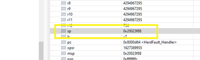

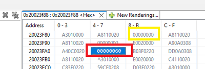

2025-02-28 8:15 AM
Hello Andrew,
Thanks for the interesting pointers. Unfortunately cortex-M0+ offer less features than M3-M4.
Anyway! Here's what I get:
SP : 0x2002 3F88
Extract from memory dump at this address:
If I did everything well, the instruction that causes the error should be at the address 0x60 which, based on the documentation is part of the information block and is an alias of 0x8000060 which is somewhere in the interrupt vector. The 18th (0x60 / 4) element of this vector is RTC_TAMP_IRQHandler.
1- Is that correct? It's suspicious to me :S
2- If yes, what does that mean?

2025-03-02 11:19 AM
2025-03-03 5:37 AM
There are 8 words pushed at the stack at ISR/fault handler entry; the last of which (which you've highlighted) is content of the xPSR register. The PC is stacked one before that. You also have the memory dump set to display MSB first (Eclipse's default, I won't comment on this here), so the stacked PC is 0x2000A40C. (In your initial post, with different version of the program, it's 0x2000160C.) This is in RAM. It's unlikely you have program deliberately in RAM, so this is probably consequence of jumping through an incorrectly set function pointer.
Try to go back in stack and look what's at FLASH addresses. Try to set breakpoints on those addresses, run the program up to there and then single-step through those points to see, where does the fault occur.
