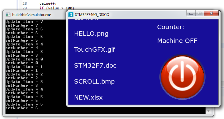

I am working on STM32746-DISC Board . I am working with "container" feature of TouchGFX with Scroll List . I have successfully update array elements (Hard Coded) as List Elements as per below link.
https://support.touchgfx.com/docs/tutorials/tutorial-04
// In Screen1View.hpp
void Screen1View::scrollList1UpdateItem(MenuElement& item, int16_t itemIndex)
touchgfx_printf("Update Item = %d\n" ,itemIndex ) ;
item.setNumber(itemIndex);
}// In MenuElement.hpp
const char Rx_Buffer1[11][20] = { "LIST.txt", "HELLO.png", "TouchGFX.gif", "STM32F7.doc", "SCROLL.bmp","NEW.xlsx", "TRY.jpg", "GOOD.bmp", "ABC.png", "XYZ.bmp" };

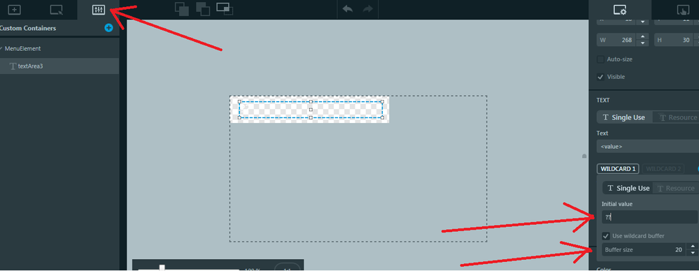

void setNumber(int no)
touchgfx_printf("setNumber = %d\n" ,no) ;
Unicode::itoa(no, textArea3Buffer, TEXTAREA3_SIZE , 10);
Unicode::strncpy(textArea3Buffer ,( const char *) Rx_Buffer1[no] , TEXTAREA3_SIZE -1 );
}I want to know:
1) Is the right method ?
2) How to Select/Highlight File Name once item is clicked .
and send Selected item (File name) to touchgfx_print windows?
3) How to add/remove the Element (File Name) from List from some other button ?
Please see short video..

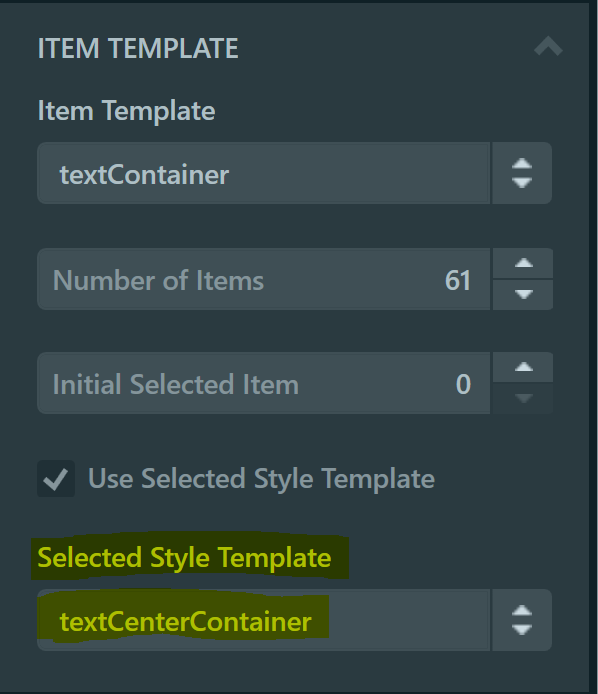

2020-05-06 3:11 AM

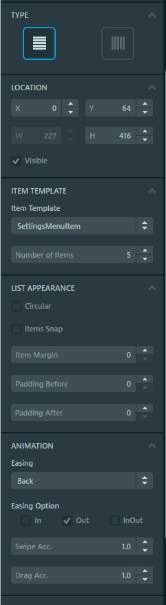

@Alexandre RENOUX Where exactly are you seeing the "Selected Style Template" option for a scroll list in TouchGFX Designer? When I have a scroll list in a view, these are the only options I have:
2020-05-06 4:01 AM
I am talking about the Scroll Wheel not Scroll List. The Scroll List does not have such feature implemented.
Sorry for the spelling mistake...

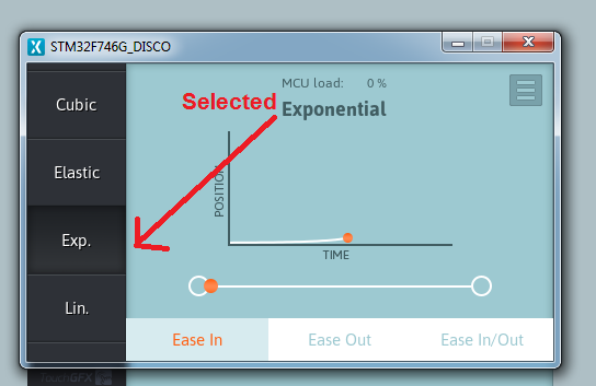

2020-05-06 4:55 AM
As you mentioned, the code of TouchGFX Demo 1 is a good reference. There's no widget you can use to do that.
The list on the left on the EasingEquation screen was developed specifically for this demo. You can look at EasingEquationButton.hpp/.cpp, EasingEquationButton.hpp/.cpp and EasingEquationView.hpp/.cpp for reference.
EasingEquationButton is a class that represents a (radio) button with a text label and an optional text shadow.
EasingEquationSelector is a custom scrolling list of EasingEquationButtons.
/Alexandre

I have go through the Demo (TouchGFX Demo 1 -> Easing Equation) . I have concluded as below:
->For Add Buttons/buttonText/buttonTextShadow
->For Make Selection of Button
EasingEquationsEnum
-> Easing Equation Selection Enum
EasingEquationPresentor
-> From Model to view
EasingEquationView
-> For Display

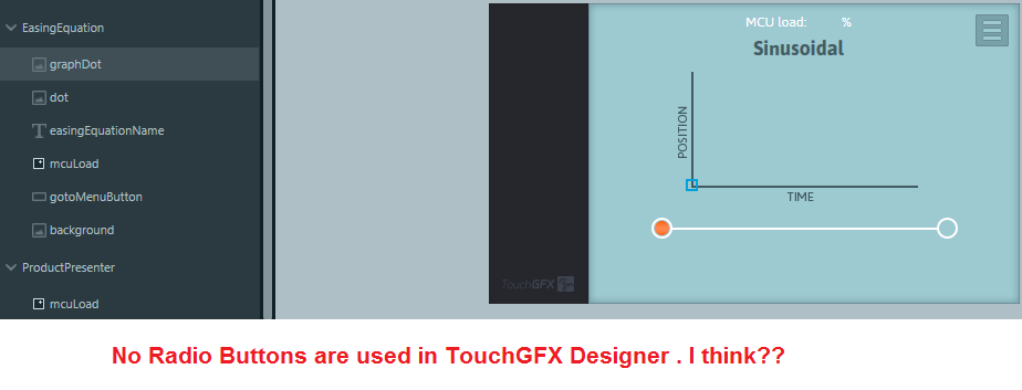

1) The radio button(s) are not used from TouchGFX Designer ?
2) Also , No Widgets/Containers are used for from TouchGFX Designer (Such as Scroll List/ List Layout ) ?
3) Everything is coded by programming ..

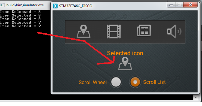

Also... I have also explore the code of Scroll Wheel and List Example v1.0.0 .
In which selected file is redrawn at center under "Selected Icon" of Screen .
Is it possible highlight that particular Image (or Text In my Case ) with Changing It's color / Highlight that with Square rather then drawing that under "Selected Icon" ?
I think It should be ...

Radio buttons can indeed be created in TouchGFX Designer. But as you can see in the code, EasingEquationButton is not only a radio button but has other attributes so you'll have to code it yourself anyway. Plus, the EasingEquationSelector is also very much customized and has a ListLayout and a ScrollableContainer.
This demo is an old demo that was created way before TouchGFX Designer became what it is now so everything was mostly implemented by coding directly.
