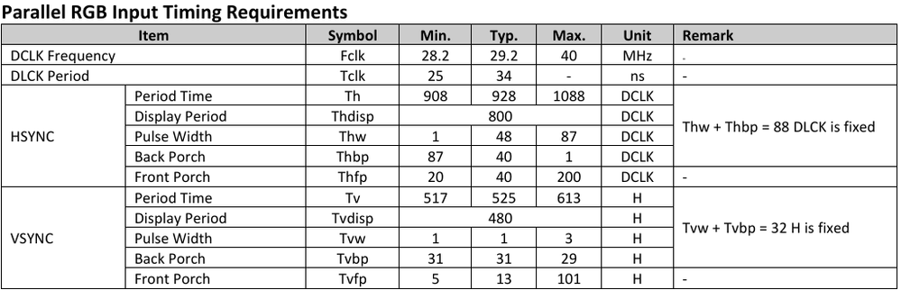

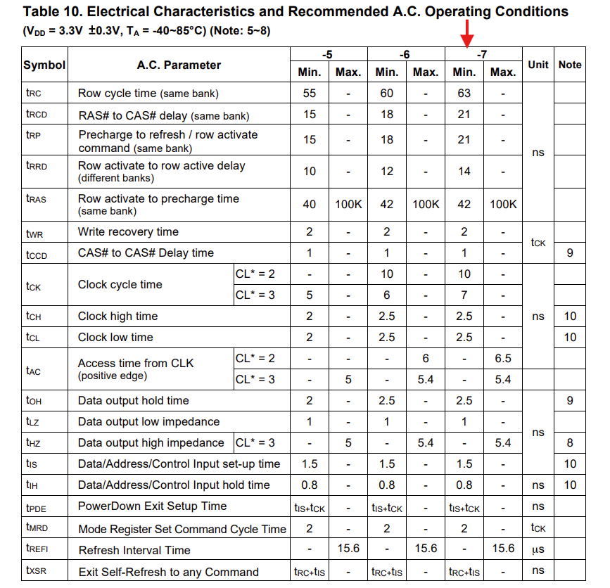

I’m working on a custom board built around the STM32F769BIT6. I’ve configured the SDRAM timings according to the datasheet and set the LTDC to RGB888. The same TouchGFX project runs flawlessly on the STM32F769I-Discovery board, but on my custom hardware the display begins to flicker whenever I scroll through a list.
Has anyone run into this before, or can you suggest where I should focus my debugging? Below are my SDRAM and LTDC settings. Any guidance would be greatly appreciated!

hsdram1.Init.SDClockPeriod = FMC_SDRAM_CLOCK_PERIOD_2;
hsdram1.Init.ReadBurst = FMC_SDRAM_RBURST_ENABLE;
hsdram1.Init.ReadPipeDelay = FMC_SDRAM_RPIPE_DELAY_0;
/* SdramTiming */
SdramTiming.LoadToActiveDelay = 2;
SdramTiming.ExitSelfRefreshDelay = 6;
SdramTiming.SelfRefreshTime = 4;
SdramTiming.RowCycleDelay = 6;
SdramTiming.WriteRecoveryTime = 2;
SdramTiming.RPDelay = 2;
SdramTiming.RCDDelay = 2;

}For reference, i have set HCLK to 200MHz and the LCD pixel clock to 29.2MHz.
