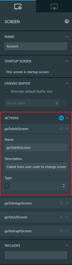

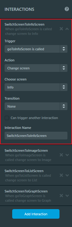

The current way to do is as follows :
You create a change screen action ( you will call it from user code later on)
Then you create your interaction that performs a screen transition where the trigger is the call of your previously created action
Then you simply call
goToInfoScreen();This will automatically trigger the screen transition.

2020-09-30 7:42 AM
I was creating an unused screen and all my desired Go To Screen Interactions, all with "When screen is entered" as the trigger, then never actually entering the screen. Then I was using a cast to grab the FrontendApplication handle and calling the relevant auto-generated goto functions as I stated in my original post.
I was missing the Action as the trigger for the Interaction. That seems like it will be much cleaner than my janky cast.
I'll give it a try.
