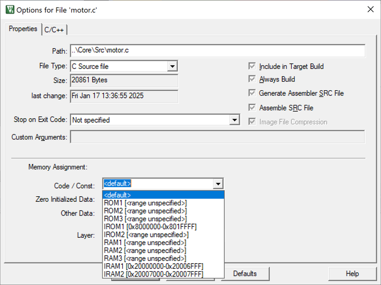

MCUs designed for little FLASH placed loader and run big code on memory mapped external flash require config some parts in project and place in main top start init memory maped ext and then can jump to any adress here as in FLASH. Learn use this and manage files to link in regions.
For example KEIL have on every file this options and you can move resulted code to areas as you need
in gcc CubeIDE you require right LD file change and ...
