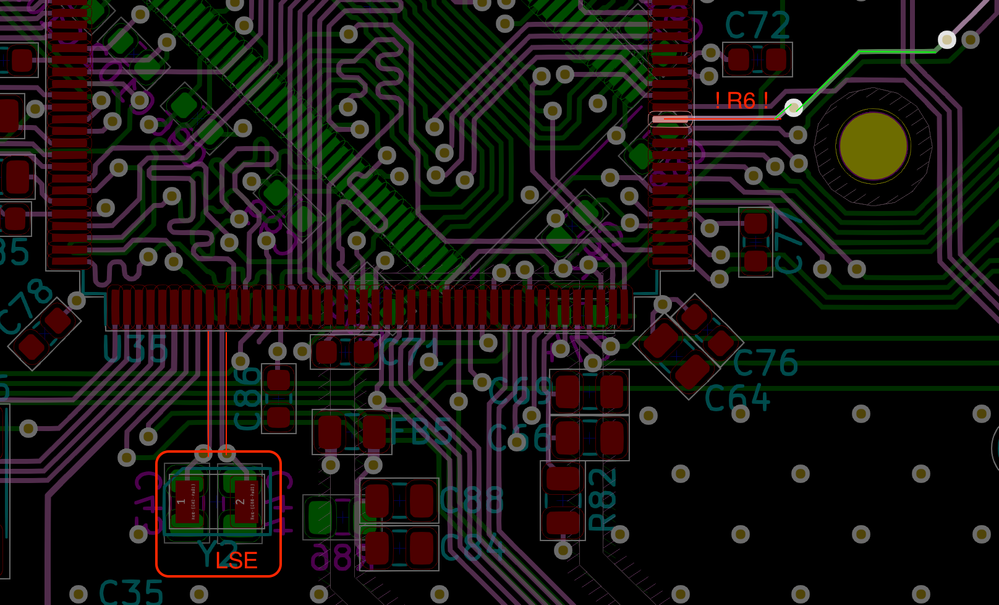

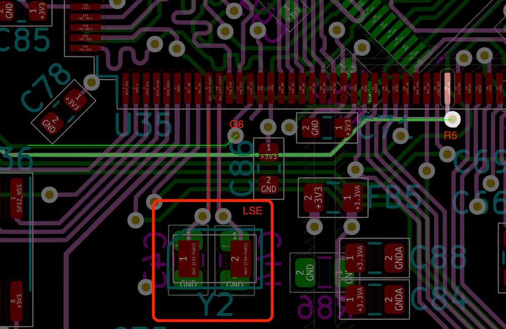

Ok, here is some progress: MCO output of LSE shows that frequency breaks when there is some changing data (random color) on line R6 (RGB565=0x4000) and it does not depend on TouchGFX - waveform breaks if I manually fill buffer with random data. All other LTDC bits are not influencing MCO at all.
But another problem is that R6 line is far away from LSE quartz:R5 & G6 line - the only ones that are going near the LSE quartz do not affect clock al all:
2021-06-03 3:39 AM

Is it FMC_D30 next to one of the LSE pins?
2021-06-03 7:45 AM
Exactly. FMC_D30 is a problem. And there is no alternatives for both LSE and D30. Only these pins.
