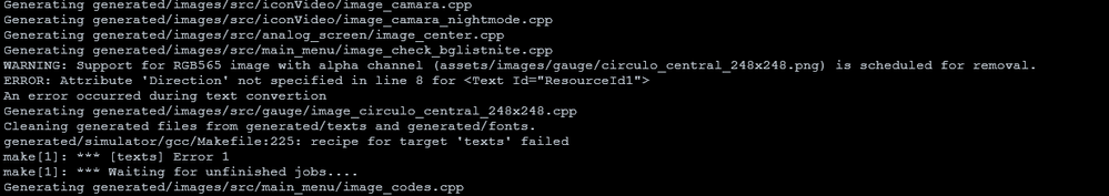

When I create a text area (or a button with text, text progress, digital clock), I encounter this problem when I generate the code.
Generate Code
Generate
Done
Generate Assets
make -f simulator/gcc/Makefile assets -j8
Reading ./application.config
ERROR: Attribute 'Direction' not specified in line 8 for <Text Id="__SingleUse_FCFO">
An error occurred during text convertion
Cleaning generated files from generated/texts and generated/fonts.
generated/simulator/gcc/Makefile:225: recipe for target 'texts' failed
make[1]: *** [texts] Error 1
simulator/gcc/Makefile:32: recipe for target 'assets' failed
make: *** [assets] Error 2
Failed

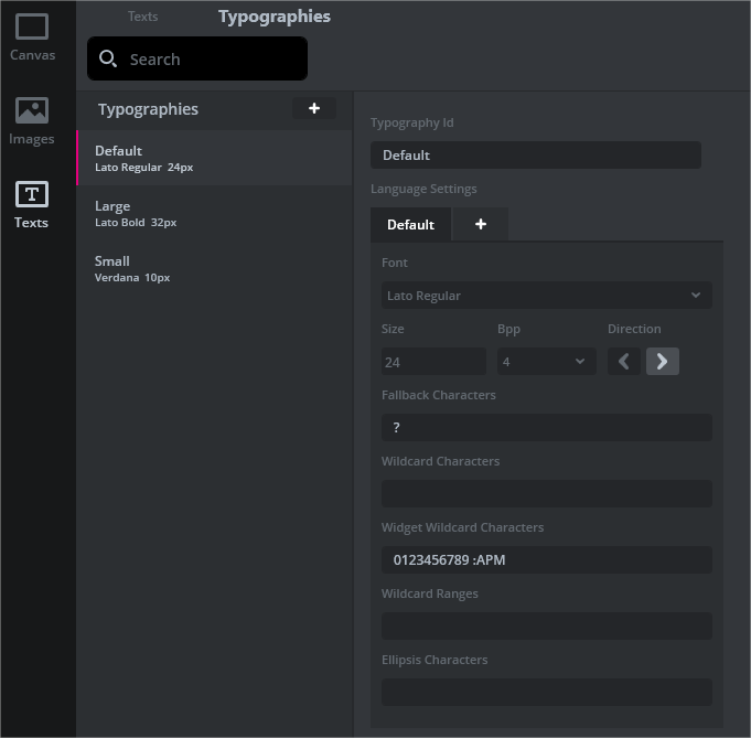

FailedI checked the direction of the typography is LTR so it is specified in there at least.

Hello @ELero.1 ,
Thanks for reporting this issue.
We investigated and found out where the problem came from.
In the .touchgfx project file, the TouchGFX version is updated to 4.19.1, which is correct. But, it seems like CM7>Middlewares>ST>touchgfx folder is included with the TouchGFX Board Setup for this board, and unfortunately those file are still under the 4.18.1 version. So, there is a mismatch between generated files and TouchGFX project versions.
We will contact Riverdi to discuss this issue.
