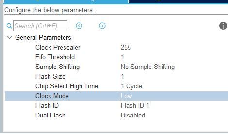

Hello, region `FLASH' overflowed by 424008 bytes but i didn't added much image. I am using 128 Mb N25Q128A13EF840E QSPI flash. I just wanted to confirm how much QSPI is assigned.
I can see below settings for QSPI.
I want to know that Where should I check in my firmware to know assigned external flash size. I can't find in linker file?
Also I want to see which all data is saved in QSPI 128Mbit .
Any help

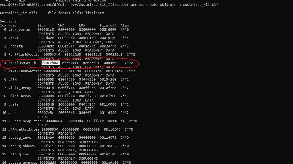

2020-07-16 12:42 AM
I dig a bit more and check using gcc objdump command. Here u can see external flash size is 0xCEB08 which I think In bytes. So this does not cross 128Mbit.
Note : In this case I removed most of images and as per compiler its almost filled.
2020-07-16 12:42 AM
