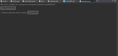

@Tesla DeLorean By using the __enable_irq(); at the main my code is getting into some signal handler with some address that i had attached below. Even using the enable_irq() at the system_init() i am still having the same issue
kindly help me out.
2025-04-12 4:48 AM - edited 2025-04-12 4:49 AM
Looks to be using the loader's vector table in RAM. Make sure SCB->VTOR points to your FLASH vector table for the application

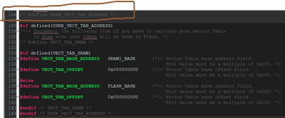

After Checking the SCB->VTOR whether it is mapping to the FLASH or not , kindly let me know am i supposed to uncomment the line 126 "/* #define USER_VECT_TAB_ADDRESS */" in the file "system_stm32l4xx.c" in the application code (not in the loader file generating project) so that the FLASH_BASE will map to the System_Init() function in the same file. Kindly refer to the below images.

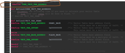

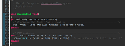

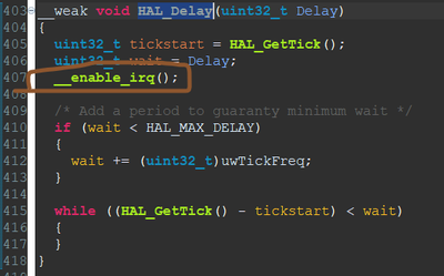

Thanks a lot @Tesla DeLorean finally HAL_Delay(); got working!!. I have made the changes to two areas to make the HAL_Delay() work, 1. Locate the stm32l4xx_hal.c file under the folder <project_name>/core/src/stm32l4xx_hal.c and go to the line 126 and uncomment the line "#define USER_VECT_TAB_ADDRESS" and that's it. 2. Open the declaration of the HAL_Delay(); and use the function __enable_irq(); after the variable initializations. Justifications as follows, on using the external loader, the external memory is mapped as a internal flash so, at the System_init(); function definition (inside the same file of stm32l4xx_hal.c) SCB->VTOR expects the internal flash's location, which is further enabled by uncommenting the "#define VECT_TAB_ADDRESS" not define the QSPI_BASE to VECT_TAB_ADDRESS (because i tried it, it doesn't work, as it is only the starting address of the external memory, not sure we can use the VTOR over there).
When the external loader is used for application project, initially all the interrupts are disabled, to eliminate the context switching besides, disrupting the flash write sequence and corrupting the data, you can observe the line __set_PRIMASK(1); //disable interrupts (an ARM register which enables or disables all maskable interrupts except NMI, Hard Fault, Reset)in the loader_src.c file in the github repo of stm32 contrib branch https://github.com/STMicroelectronics/stm32-external-loader/blob/contrib/Loader_Files/other%20devices/Loader_Src.c#L58 so, Systick (a Maskable Interrupt) which is responsible for creating the HAL_Delay(); is disabled as a result of external loader usage, so we are supposed to enable the interrupts again, by using the function call "__enable_irq();" after the variable initializations inside the HAL_Delay()'s Function definition (press F3 or right click and select open declaration). Kindly let me know if there are any other approaches for this or any changes to be made in my justification
