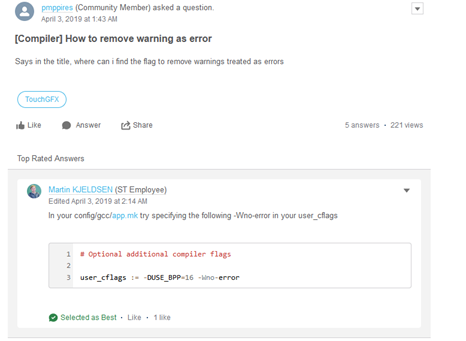

Where can I set the switch "-Wno-error=sequence-point" so that the compiler does not define this warning as an error and aborts?
I don't want to resolve the warning, I want the warning to not stop compiling.

Look for a compiler option -Werror and remove that, or add -Wno-error=sequence-point.
See https://gcc.gnu.org/onlinedocs/gcc/Option-Summary.html for all details.

Thank you very much ferro.
I didn't feel like explaining to colleagues the difference between "++i", "i++", "i += 1" or "i = i + 1".
Sadly enough, GCC had to define a "warning" for this.
You saved me a lot of time and effort with your competent and solution-oriented answer.
Thank you very much!
