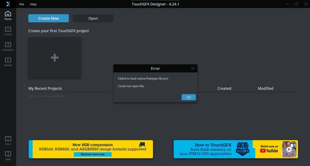

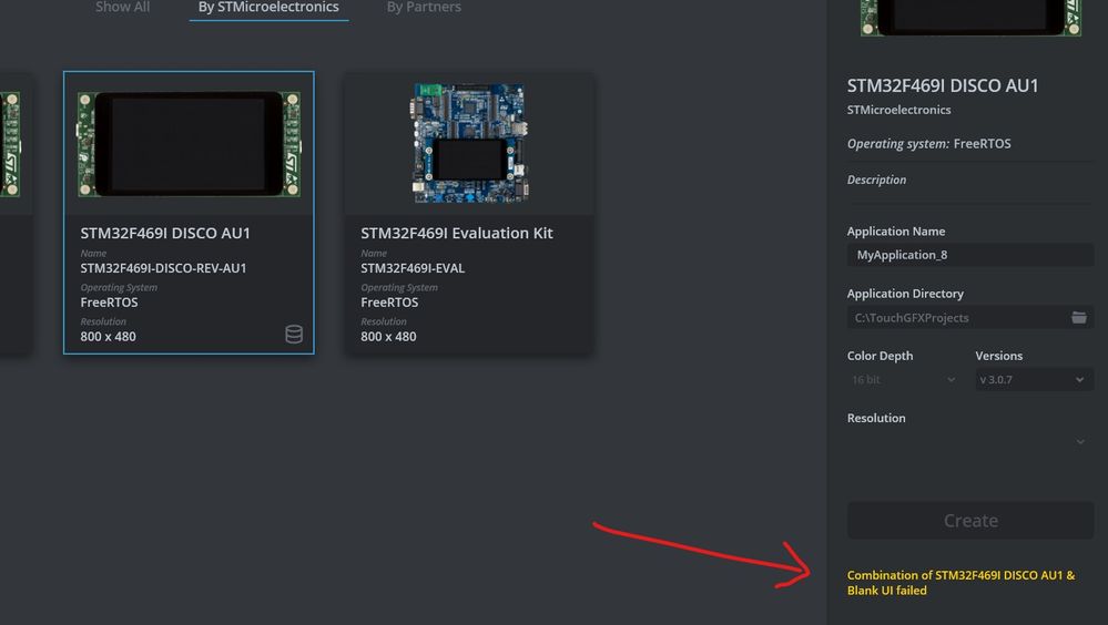

I am trying to create a project in Touchgfx designer 4.24.1 for STM32F469I-DISCO board but I always get "combination of board and Blank UI failed". I also tried with other boards without success. I am using fresh installed windows 10. I also tried to uninstall and install back again Touchgfx. Bellow is my log file from appdata/roaming...

2024-10-28 16:44:51,478 [11] INFO Utils.WebHandling.WebHandler: Downloading stm32-desc-7inch-1.png
2024-10-28 16:44:52,206 [11] ERROR Utils.WebHandling.WebHandler: One or more errors occurred. (Response status code does not indicate success: 404 (Not Found).)

2024-10-28 16:46:46,181 [.NET ThreadPool Worker] ERROR TouchGFXDomainModel.LoadSave.LoadSave: Failed to load native freetype library!
System.IO.FileLoadException: Failed to load native freetype library!

Is that an error thrown by the TouchGFX designer?
What "Riverdi" is doing here? Are you sure you are starting with STM32F469I-DISCO board not with a Riverdi board?
2024-10-28 16:59:07,775 [11] ERROR TouchGFXPackages.Implementation.FileDownloader: Failed to download: https://cdn.riverdi.com/wp-content/uploads/2022/07/stm32-desc-7inch-1.png
2024-10-29 9:02 AM - edited 2024-10-29 9:15 AM
Yes this is an error thrown by Touchgfx Designer.
I definitely tried to create a project with STM32F469I-DISCO board, without success. After that I also tried to create only simulator project with no board but also failed. Then I also tried with other boards but I don't remember trying Riverdi.

Some more info (maybe it will help) @GaetanGodart @mƎALLEm
When I press Create button it starts creating the project but fails at about 90% then Touchgfx crashes.
After that I tried to open the "partialy created" project but I got an error: Failed to load native Freetype library! could not open file.
2024-10-31 3:48 AM
Found the solution. I was missing VC++ similar to this post: https://community.st.com/t5/stm32-mcus-touchgfx-and-gui/touchgfx-crashes-on-project-creation/td-p/578159
