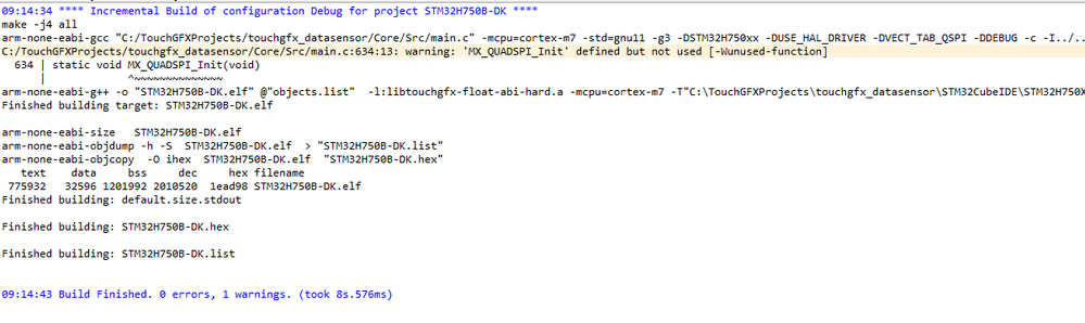

Hi, may I know what cause of this warning? how can I solve it?

>> how can I solve it?
Use the function?
The deeper problem here is perhaps you're using the QSPI for the entirety of the project code.
I'd probably opt for a small boot-loader that brings up the clocks, and external memory, and calls into the App code in the external memory, and then NOT repeat the clock, pin, QSPI stuff again.
If your code is split between internal/external flash memory then you'd need to bring up the external memory before touching it, otherwise it will Hard Fault.

Not using TouchGFX or this board.
The size of the software seems to exceed the size of the internal flash (128K), so some of it is going to have to exist in the external memory.
I don't know how your project/memory is mapped out.

I using the STM32H750XBH-DK board. What i want to do just display the sensor value on screen. But the uart also seem doesn't work on me. the thing I curious is when I using the board setting without touchgfx everything is ok but when I want to use with touhgfx everything go wrong.

You showed warning is basic C warning about declared but not used func.
For your board QSPI init is critical part and maybe as beginer better is start with other MCU...
