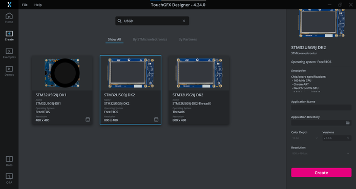

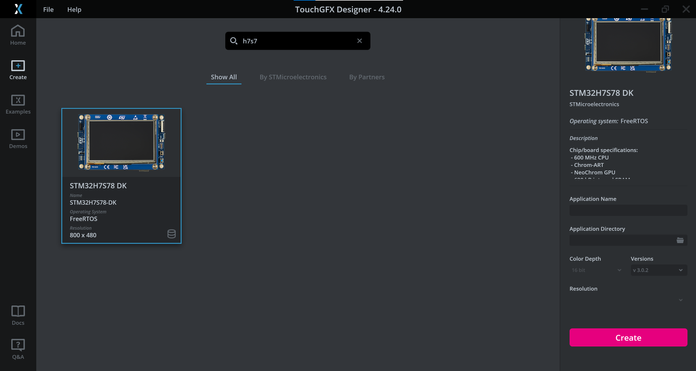

Hello @Shivani ,
Both of the MCUs that you mentioned are excellent choices for graphics since they both support the Neo-Chrome accelerator. TouchGFX already have board setups ready for STM32H7S78 DK and STM32U5G9J DK2 to start developing your GUI as fast as possible, and Neo-Chrome is fully supported.
Board Setup for STM32H7S78 DK
Board Setup for STM32U5G9J DK2
Here you can read about the new features of TouchGFX 4.24.0
