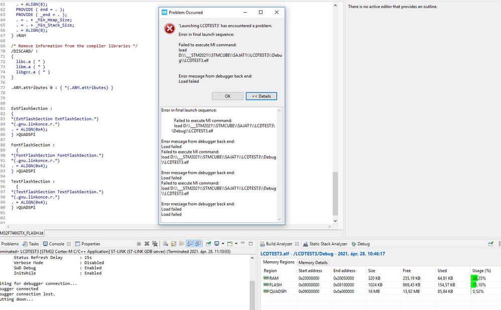

The problem is that the firmware isn't loaded on my board and I have this error:
Can someone help me?

Many thanks to reply me. I copy the stldr file, and use it. It seems to be someting is not good.
Where i search the problem?
Kind regards
Peter

Your external loader works with STM32 Cube Programmer. It is fine.
But i haven't to adapt in Cube IDE.
Which is the best setup, to debugger?
kind regards
Peter
2021-04-28 5:01 PM
I suspect it is in amongst the metadata of the settings/options. Probably in the debugger settings.
I'm primarily a Keil guy, I use GNU/GCC via makefiles
