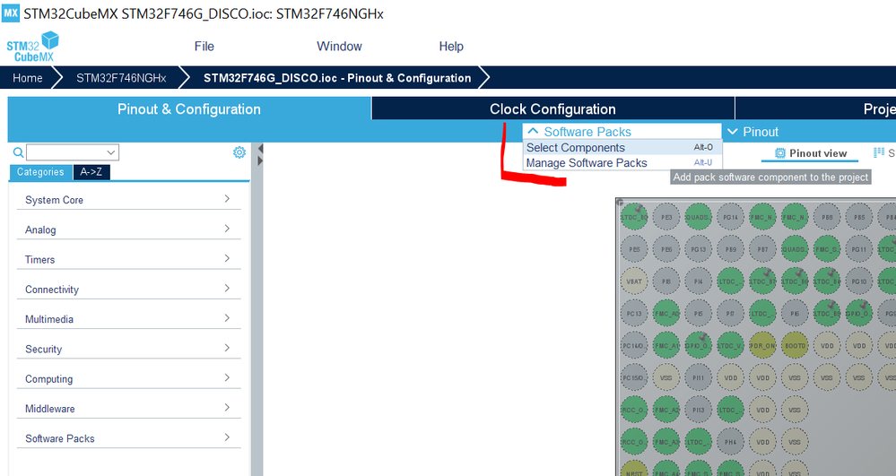

Click on the Software Pack button in the top of your screenshot. It will open a dropdown menu where you will be able to select Additional Software like in the screenshot in the article I shared.
/Romain
2021-07-12 2:46 AM
Actually my bad, in this dropdown menu click on "Select Component" and not Additional Software which does not exist sorry.
/Romain
2021-07-12 2:48 AM
See below screenshot
/Romain
2021-07-12 3:35 AM
i went to select components and installed xcube-Touchgfx 4.17.0 . but its not appearing in my categories for configuring. My question was the same from the beginning. Is there a way in settings to see additional packages to categories menu. So that i can configure ex: RGB8888 etc.,?
