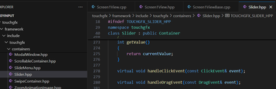

Side note:
@GaetanGodart, I noticed a bug in the slider. I can just click at the right of it and it will trigger its completion. No sliding required. Not sure I will have time to send you a patched version to explain the bug.

2025-05-26 2:32 AM
Hello @Marc_LM ,
The slider behavior is not a bug.
If you add a slider (without a scrollable container) and press on the bar itsleft (not on the rectangle that moves), the rectangle that moves will snap to where you clicked.
This has recently been brought to TouchGFX's attention that this is not the prefered behavior and we will discuss what is the best implementation.
I am no aware of something telling you that a child entered handleXxxEvent.
However, you could clone the widget you want and modify their implementation of that event handler function to send some kind of signal of your choice :
Regards,
