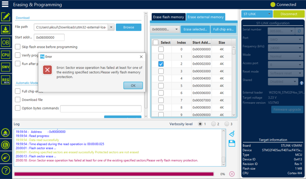

Hello everyone, I've got custom-made board with STM32F407VE and W25Q16 SPI flash with TFT Display installed.
So I've decided to develop my own external loader for SPI flash for storing images in my TouchGFX project. I've managed to read data from flash with st-link utility and stm32cube programmer but encountered some problems.
And because of these issues I can't write data to flash, And I don't even know if write function will work, and I still need to figure out how to use it in TouchGFX project.
Edit: It turned out I'm able to erase one sector in stm32cubeprogrammer if I don't do anything except erasing after connecting. If I touch anything before erase command, It fails. Still can't erase multiple sectors at once.
Please help…
Here are my functions I found in st-link utility folder (stm32cubeprogrammer has the same source code).

}Here's CubeProgrammer erase fail screenshot
2021-05-14 7:15 AM
Solved.
Init() function called every time before other functions. So SystemClockConfig was called several times, causing a hard fault. I've removed it from Init and erase, read and write operations work fine, but it looks like verify isn't working correctly.
