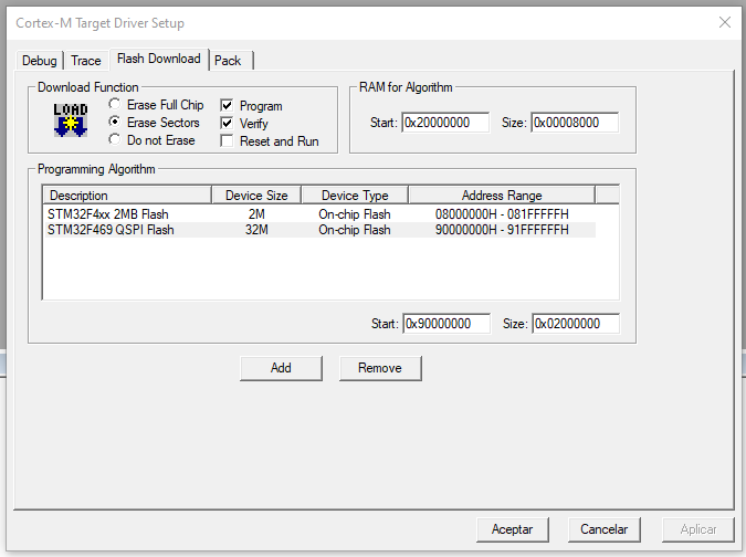

I am using STM32F469I-DISC0 board to test TouchGFX demonstration examples with Keil MDK.
I have downloaded STM32Cube_FW_F4_V1.26.0 SDK, and I am trying to get running the project at path:
..\STM32Cube_FW_F4_V1.26.0\Projects\STM32469I-Discovery\Demonstrations\TouchGFX\MDK-ARM\touchgfx_demo2015_800x480.uvprojx
The project compiles without a problem, but when trying to download it to the board, the output console print errors related to the flashing algorithm:

I understand that this is because some parts of the code (which contains TouchGFX primitives) should be downloaded into the external flash mapped to section 90000000H - 9083569FH, am I right?
So, trying to get the example running, I added "STM32F469 QSPI" Flash algorithm from Options for target->Utilities->Flash Download tab, as can be seen in the picture below:
After this change, the output console indicates the following error during the verification stage:

You need to use STM32CubeProgrammer and select the external loader for the STM32F429 disco board in order to flash on target.

2021-04-27 6:19 AM
Make sure the memory is erased before starting
Double check that the algorithm is correct for the board/memory in use here
As I recall the STM32F469I-DISCO had an N25Q128A (16MB) memory, so 0x90000000..0x90FFFFFF
And the STM32F469I-DK a MT25QL128A
The EVAL board has the 32MB device
