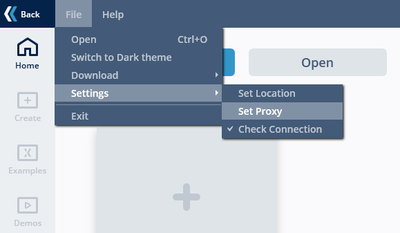

I am unable to connect to TouchGFX version 4.26 to download or access the demo and example projects from the software download section.
My system is connected to the internet; however, the application itself does not connect to the server.
Please let me know how I can resolve this issue.

You can configure the proxy settings for TouchGFX Designer in File -> Settings -> Set Proxy. If other applications can access the internet, try to use system proxy. Otherwise, you can also configure a manual proxy.

Thank you for your help and guidance. My problem is solved.
