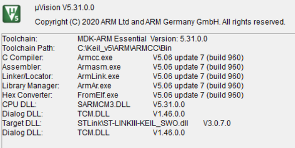

Dear Romain, I am happy you replied so fast, thanks for that. I use the following version for Keil: CubeMX 6.1.1
ToucGFX 4.16.1

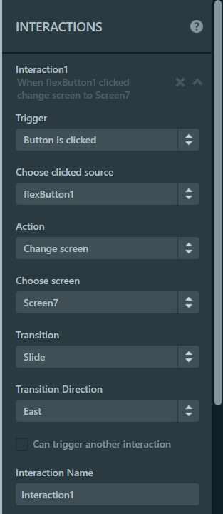

I only display full screen images (PNG) and the target is to make a demo (as software development is just started we want to make some impressions on how UI could look) The current design consist of 8 pictures (although more are in the design but I have issues deleting them (please advice)? Image 6 is the start image and after the screen transition a timer is started and when finished it goes to the next screen, when at screen 12 after the timer is finished we jump back to the start screen 6.
I added also two flex buttons per screen, one on the bottom part and one on the top part to be able to advance quicker to the next picture (the bottom Flex button) and one to go back to the previous picture (the top located flex button). In simulation this is all working, on the target everything works except the flex buttons to go back to the previous picture.

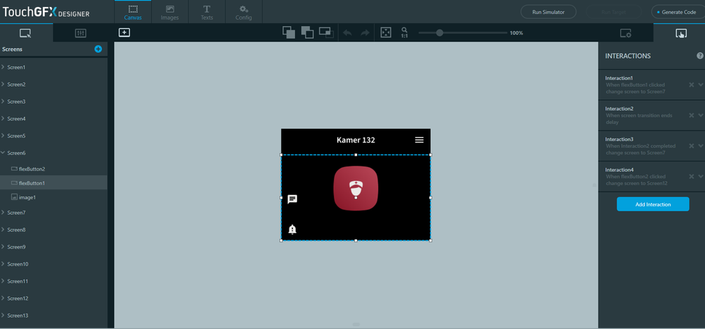

Please find below a screen shot of the Designer:

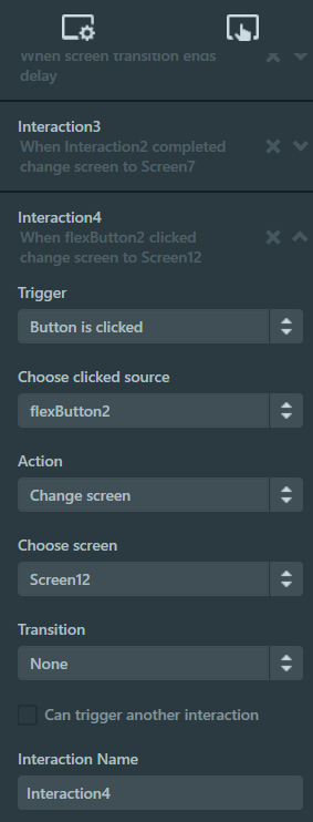

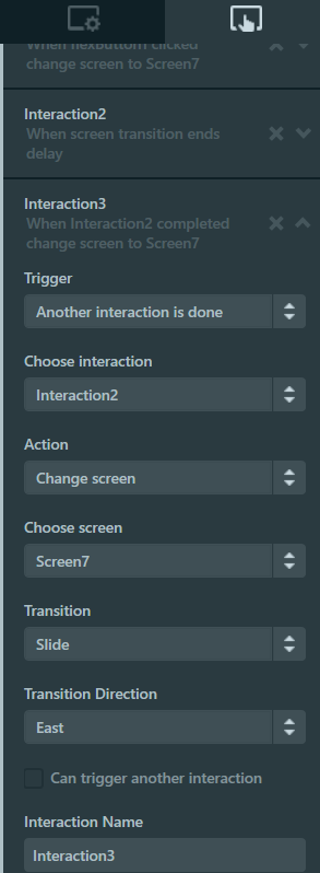

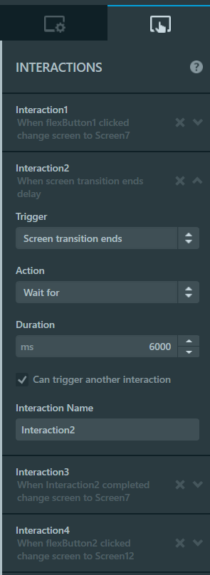

Here the actions all based on screen 6 picture and the two flex buttons:(I had to split them)

The flex buttons to go to the next picture work but not to go to the previous one right ? In the screenshot the flex button 1 seems to take most of the screen, is the flex button 2 overlapping the other one or taking the rest of the screen ? I dont see something strange in the interactions you set, maybe just the "wait for" action that intrigues me ( i cannot remember if it freezes the rest of the GUI or not until the 6s have passed)
