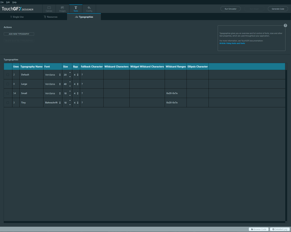

2020-02-06 6:34 AM
I recommend adding the entire ASCII character set to your wildcard range for the font that you are using. This will allow you to leave your TextArea blank.
In your Wildcard Ranges field enter the values: 0x20-0x7e
