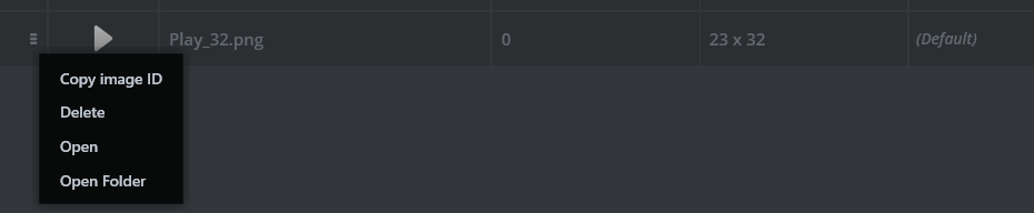

}also include "BitmapDatabase.hpp".
the bitmap id can be found in the images section of TouchGFX:
