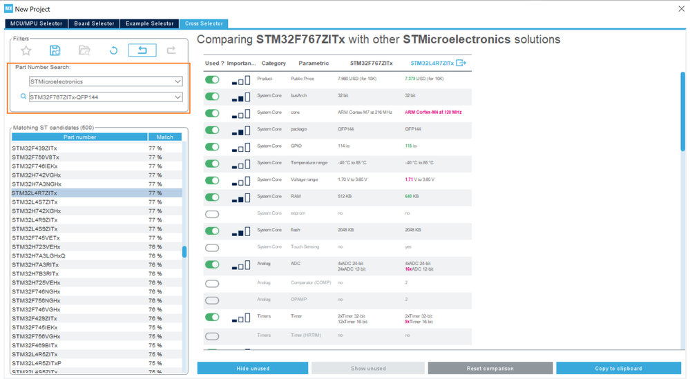

What I can recommend in this situation is the use of Cross Selector feature integrated in the STM32CubeMX tool, it allows you to find products of the STM32 portfolio that best replace the STM32F767ZI MCU you was using ( you will find a detailed description of this functionality in CubeMX User Manual- 4.2.4 Cross selector section:(

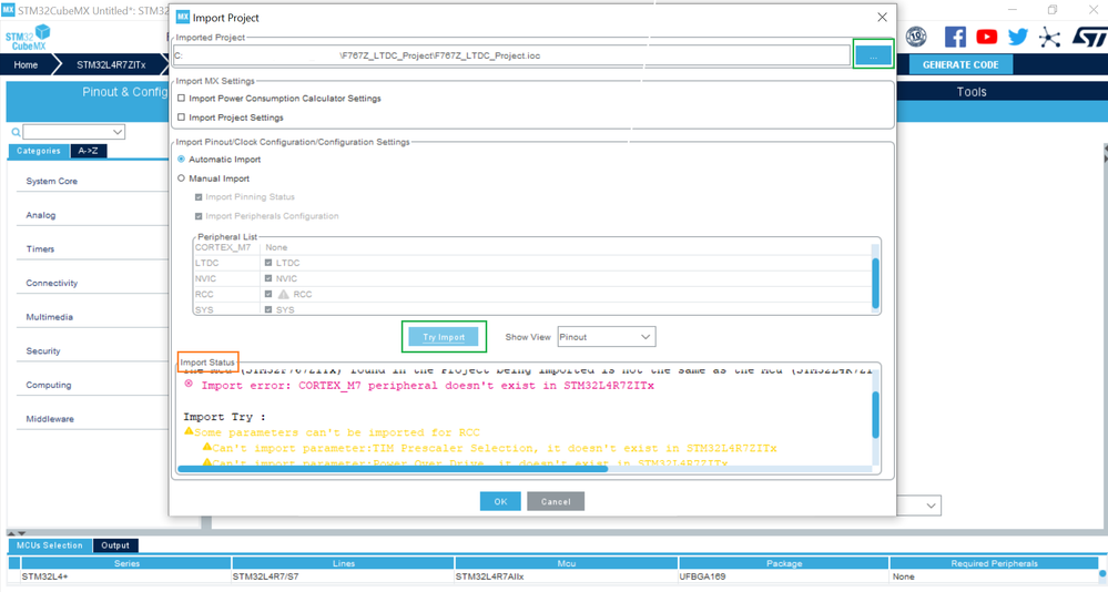

Once you choose STM32L4Rx MCU you'll work with, you can start a new project based on that MCU ( STM32L4R7ZITx for instance which is matching up to 77% the STM32F767ZI device) and without doing any further changes, use the Import Project menu that imports the previously-saved configuration with NUCLEO-F767ZI to another MCU (STM32L4Rx). By default the following settings will be imported:
  • Pinout tab: MCU pins and corresponding peripheral modes. The import fails if the same peripheral instances are not available in the target MCU.
  • Clock configuration tab: clock tree parameters.
  • Configuration tab: peripherals and middleware libraries initialization parameters.
  • Project settings: choice of toolchain and code generation options.
0693W00000DqFptQAF.pngYou can refer to the STM32CubeMX User Manual for more details about all the tool feature.

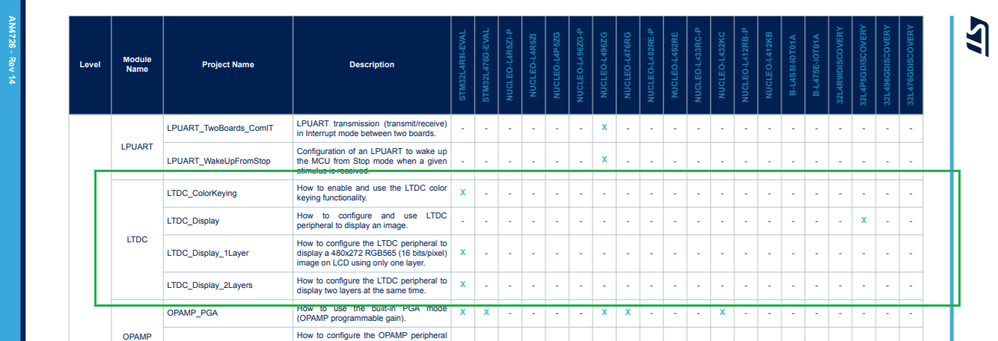

Otherwise, The STM32CubeL4 MCU Package is delivered with a rich set of examples running on STMicroelectronics boards. One of this examples can be a good start point to launch your project based on STM32L4Rx PN:
0693W00000DqFtvQAF.pngYou'll find the table resuming the available examples in the STM32Cube MCU Package examples for STM32L4 Serie Application Note.
