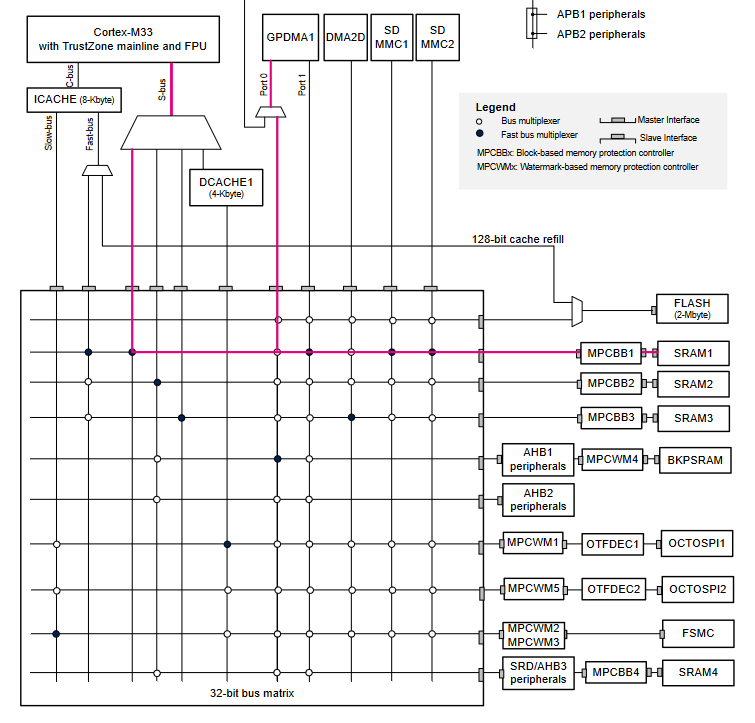

My main concern is that I will be loading AHB bus while DMA is copying data from DCMI to SRAM. If I set DMA with highest priority, as far as I understand I could get DMA overrun, since ARM core access priority is larger than DMA?
Where do you have that information from?
There is not much information about the details of arbitration between the busmasters in STM32 bus matrices, but all the information available indicates that in AHB bus matrices it's usually simple round-robin arbitration, i.e. all busmasters stand the same chance to access a single slave bus.
Maybe you want to read AN5593. You can also benchmark on available Nucleo boards, imitating the camera by generating clocks using timers.

I don't think its a priority issue as much as it s a bandwidth/saturation issue.
Doing things at wire speed would seem to suggest a FPGA/CPLD is still a better solution.
Are you able to drop the frame rate, or use a FIFO memory?
Check if your STM32 has different SRAM banks with independent bus matrix plumbing, perhaps you can ping-pong between different area using the DMA "double buffer" modes.

In case of concurrent accesses from the CPU and the GPDMA, the bus matrix arbitration rules the access to the SRAM1. If the last access is from the CPU, during the next access, the GPDMA wins the bus, and accesses SRAM1. After the CPU can again access SRAM1.
Based on this it looks like if I read data to registers from memory, and perform operation without SRAM usage, GDMA will get priority and write data to memory. So while camera is pumping data to SRAM, i need to have sufficient NOP's operations allowing GDMA to do it's job, and after last byte from camera, i should jump into high performance mode without any NOP's
In this situation, nop's needs to be tailored to bus load so I would never receive overrun.
Is this ok or stupid thinking ?
